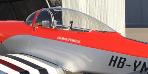

In Switzerland we no longer have the option to label our aircraft Experimental to warn would-be passengers that they are about to get into a contraption that was built by a “crazy” person in their garage. The new terms are either Homebuilt or Eigenbauluftfahrzeug. No French option, for some reason. I chose the German.
Guess that makes it the only aircraft in the wold with the Eigenbauluftfahrzeug as an outside placard 😉
I would have gone with that too! I love how German combines related words into one word. Makes me think of my favorite word from my German studies, Bundesausbildungsförderungsgesetz, which for those that are wondering, is the name of a law relating to educational financial assistance.
