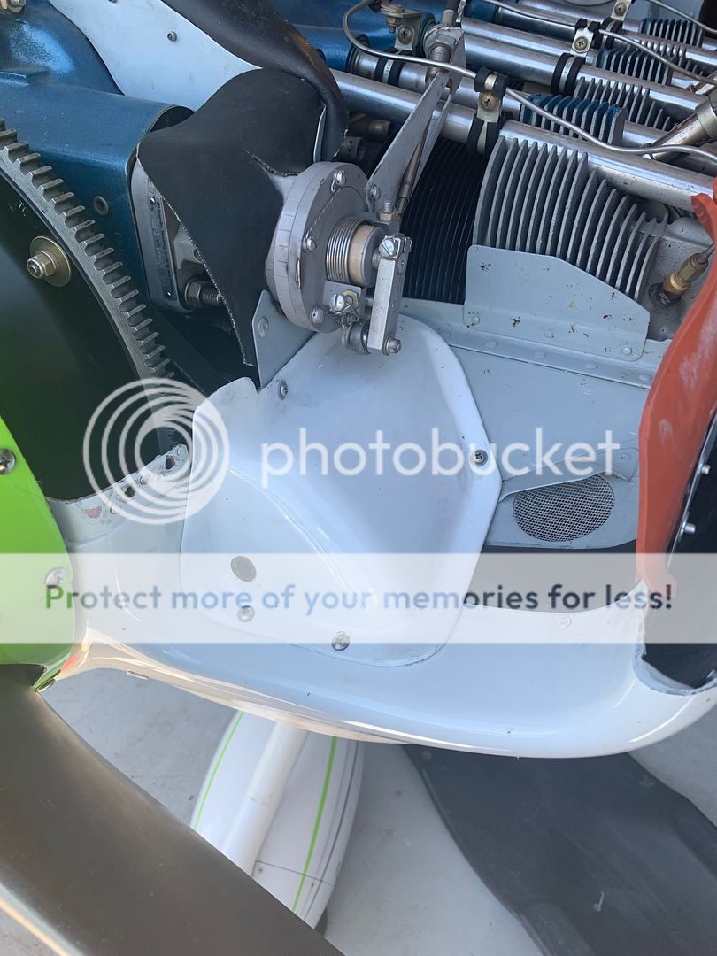

A lot of work was put into lowering the compressor into the cowl to make the L/H Cowl intake as unrestricted as possible. New Idler extensions and compressor spacers were made. Bill at Airflow Systems said he will be adding the required extensions and spacers to those builders who require them.
Spacing the A/C compressor outwards by 7/16? and using the new longer idler arm meant a new longer belt was required and a relief cut into the lower cowl.
Before Lowering Compressor ...
....and the new Compressor location.
The intake ramp was modified and the removable rubber transitions were added.
