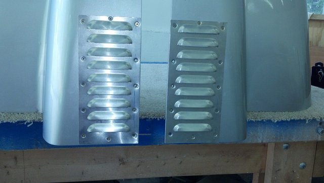

Brad,
I know all the stories from ~10 years ago about people having cooling issues when using the RV-10 James Cowl and plenum. All this happened right before I finished the RV-10. As a precaution I added these louvers on the bottom of the cowl.
I can report that the only real cooling issue I had was on the first couple of flights - and that was my mistake. I should have not installed the dams in front cylinders #1 and #2. This RV-10 now has over 1000 hours and is a joy to fly.
Note - there is no free lunch. The reduction of cooling drag with this setup is the gain. If you want to install a fire breathing “Time to Climb” engine and fly it that way, then you will have cooling issues (most likely independent of what cowl you use).
I can also report that Jimmy at James Cowl has completed a new RV-10 cowl that is set up for the IO-540 with the Cold Air Sump. This is what I’ll use. The new engine will arrive from Thunderbolt around September.
