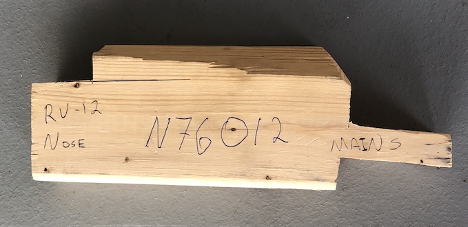

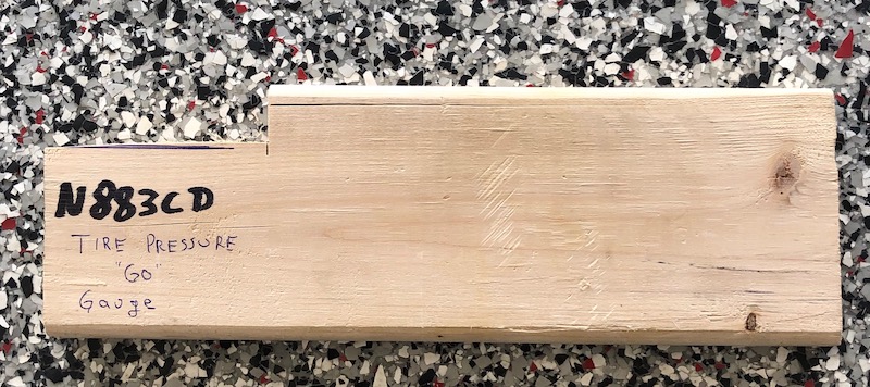

I made a wooden "go/no-go" gauge for my planes.
  • Take the pants off
  • lower the pressure to the minimum that you will tolerate flying.
  • Put the pants back on.
  • Take a scrap of wood and make a notch on one side.
  • File the notch until it just barely passes under the wheel pant.
  • Repeat with a different notch (if needed) for nose wheel.
  • Remove pants
  • Re-inflate to desired max pressure
  • Re-install pants.
Preflight check now consists of putting the gauge against the tire. If the wheel pant prevents you from doing so, you are too low to go.
(Ignore the notch below the Mains side of the RV-12 tool).
Keep in mind that ambient air temperature and tire wear can impact the results of the gauge's use. It is nevertheless a helpful approximate indicator as to tire pressure and tread condition since it requires you to get down and dirty and look at the tire close up.

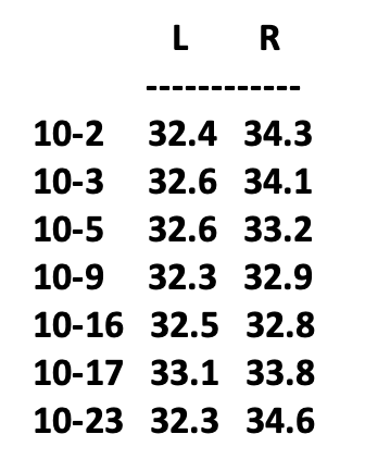

The wheel pants aren’t that big a deal to remove front half to add air for main wheels. I have TPM’s on both main wheels so I don’t have to dick with the wheel pants unless absolutely necessary. At the beginning of October, I added some O-ring sealant on the valve stems and it improved the TPM sealing. The O-ring sealant looks like a real sticky silicone grease. I use the TPM cell phone app as part of my preflight and log tire pressures to spot any problems.
