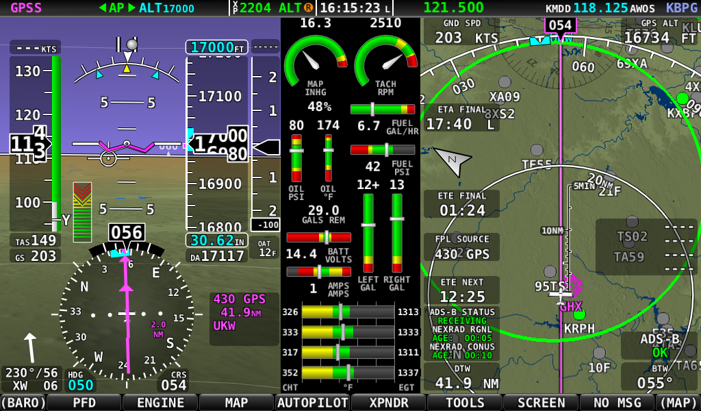

That's a tailwind of 56 kts... gettin a little help there, headed 054, gonna pay for it when you head back home. How much motor and HP are you running in your bird?
You asked about the difference between the airplanes, not about headwinds and tailwinds. I'm getting better than 22 nm/gal TRUE in that photo at 149 knots true, at 17,000'. That's what my 9A can do, and I still have a ton of drag cleanup to complete.
The two planes are not the same - they each have niche to fill. Different pilots have different missions. Pick the plane that fits your mission and fly it.
17K
Apparently the Roncz airfoil wing likes 17,000 feet. Nice!

Yep, I'm still chasing drag reduction and I've got quite a bit to work on. I'll be happy when I'm showing similar numbers to Bill. Not having a nose gear hanging out in the slip stream is a plus for him.

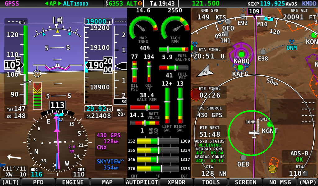

The Roncz airfoil definitely does like higher altitudes - I've had my 9A up to FL210 but I get my best efficiency between 14,000 and 17,000.

I know that when I leveled at 17,000 going to Hot Springs last weekend I was climbing on autopilot at 500fpm and 98 knots indicated, solo with full standard fuel and about 80 or so pounds in the baggage compartment. When I came out of Reno with 67 gallons and about the same baggage I leveled at 19,000 climbing 300fpm at 96-98 indicated, that took me direct home in just over 6 hours and I landed with just over 3 hours cruise fuel still in the tanks.
