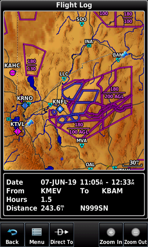

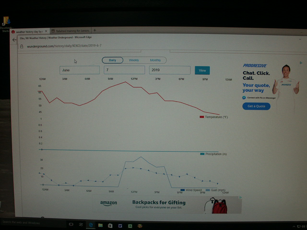

Battle Mountain, NV (KBAM) had some interesting winds last year on the 7th of June 2019.
Battle Mountain has 4-big runways, first runway was not an option by the time I arrived. Decided to commit to the second choice as the wind was changing to that direction. Timed it well, not a bad x-wind at 30 degrees. The Gusts were interesting; rock and roll all the way to the ground, love the handling the RV provides.
Plenty of rudder still available. You actually had to fly the RV on the taxiway, the whole way to parking! One of the reasons took the runway used, the taxiway would be almost aligned with the wind direction, did not want that kind of wind behind me.
Big guy came out and leaned on the wing when tying down. Nice crew and a courtesy car available. Discount rates at one of the hotels in town.

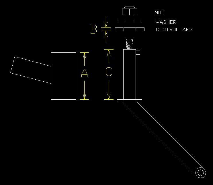

That's odd. The washer sits on top of the shaft, and is clamped firmly to the shaft with the nut. The washer sandwiches the control arm between the top of the housing and the underside of the washer with a small clearance set by the relative lengths of the housing and shaft. Put another way, the sum of A+B is slightly less than C, ballpark 0.020". The control arm will have a little wiggle room with the nut fully torqued.
I'm sure that is the way the tailwheel yoke is designed, but both tailwheel yokes I've used on my RV-6 have required a bit of finesse when it comes to tightening the nut. It is possible to get the nut tight enough to bind the yoke, but it isn't difficult to adjust for smooth operation (sorta like tightening/loosening an axle nut). Perhaps there was some manufacturing variation in the housing.
So you guys are operating with the washer not firmly clamped to the top of the shaft? That ain't right.
BTW, I understand the axle nut analogy, but if the washer is free to rotate, the nut needs to be keyed, just like that axle.
Dan, I don't know how much the washer is rotating, but the nut hasn't loosened in twenty years between many relubes/servicing. It only takes a tiny bit of rotation of the nut to take it from too tight to just right. I've considered filing the housing a few thousandths but since there have been no service issues and the tailwheel works flawlessly I've left well enough alone all these years.

I, too cannot fully tighten the nut without it binding. So I tighten ?just enough? to where it doesn?t bind.
The big washer is adjustable! Take the washer and stick a bolt in it., half inch diameter bolt should work. Drop this into the end of a short piece of pipe mounted in a vice. Now wack the end of the bolt with a hammer. You will introduce a washer that is now slightly concave. This method can be used to fine tune the clearance of the washer ?tension? on the bolt and remove any vertical slop in the tail fork.
It is also very satisfying to hit an airplane part with a large hammer.
What Dan says is correct. If you aren't tightening the large top nut down all the way, something is wrong.
There are manufacturing variations between different vendors and batches, and plain old wear to consider.
When everything is brand new, the fit may be tight. If it's so tight that the assembly binds up when you tighten the nut ALL the way down, then it is acceptable to remove a wee bit of the bronze bushing on the bottom of the housing to make it fit properly.
Later, when Mother Nature's dirt has worn that same bushing down a bit, it is acceptable to add a shim washer. Blake sells stainless washers in .015", .020", and .025" thicknesses.

- Tailwheel assembly binds or feels tight
○ If the tailwheel steering feels tight on assembly, the likely culprit is that the top nut is compressing the wrong parts of the assembly. If you look across the top of the assembly, you've got the top surface of the control arm which is probably just about in line with the top surface of what I'll call the "shoulder" of the tailwheel shaft. For proper function, these two surfaces need to be close to coplanar, but the "shoulder" should stand out "proud" - just above the top surface of the control arm.
○ If the opposite is true, and the control arm surface sits above the shoulder of the tailwheel shaft, the system will bind, as the washers on top will tighten onto the control arm, which will then compress the outside of the mounting socket to the bottom of the tailwheel fork. You can easily tell if this is the case, as the tailwheel will feel tight and resist swiveling when the top nut is tightened down but will loosen up if the nut is backed off.
○ You can solve this issue by carefully removing material from the top of the mounting socket using a belt sander, ideally just enough to get the tailwheel shaft shoulder above the top surface of the control arm. Alternatively, you can add a 1/2" ID shim washer to the top of the tailwheel shaft shoulder (find these shim washers on our website)
○ Note that if you have the JDAir mounting socket (or tailwheel yoke, as they call it) with the needle bearings in the shaft, you should not sand this unit, as it will likely result in debris from the sanding getting into the needle bearings. Instead, use 1/2" ID shim washers on top of the tailwheel shaft to configure the assembly.
