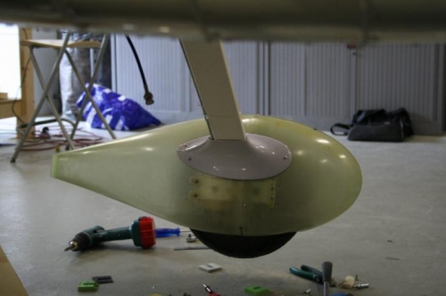

I could not believe the drag our gear legs present in wind tunnel testing, so I went all the way with RV8 gear leg fairings, looks nice that way as well:
I did the same, frankly mostly to try to reduce the flow of air that comes forward between the seat backs. I thought some of the air might be coming in the gear leg openings in the fuse (the jury's still out on that) but expected to see come increase in speed. The difference appears to be negligible ...
I also followed Don's example, mainly for appearance and in the hope that the fairings might add a knot or two. I haven't done any comparative testing but doubt that it would be any more than that since the pants themselves only add about 5 kts. It sure looks faster on the ground though.
I believe I read on the other rv models it has been tested and found there is as much speed gain from the gear leg fairings as there are from the wheel pants. YMMV

Did not happen with the installation on my -12 which is just like Don's picture. No perceptible change with the leg & intersection fairings. Gained about 6 kts with the wheel fairings ...
Please see post# 19 in this thread. There are others as well that experienced the gains from the gear leg fairings. http://www.vansairforce.com/communi...22&highlight=Gear+leg+fairings+speed+increase
Just a data point on a different landing gear design. The aerodynamic affect on the two are different, so perhaps the speed increase from the leg fairings on the rv12 are not netting the same effect.
