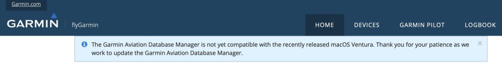

Yup. From the Garmin web site:
The Garmin Aviation Database Manager is not yet compatible with the recently released macOS Ventura. Thank you for your patience as we work to update the Garmin Aviation Database Manager.

Banner on Garmin as of 2023-01-03
