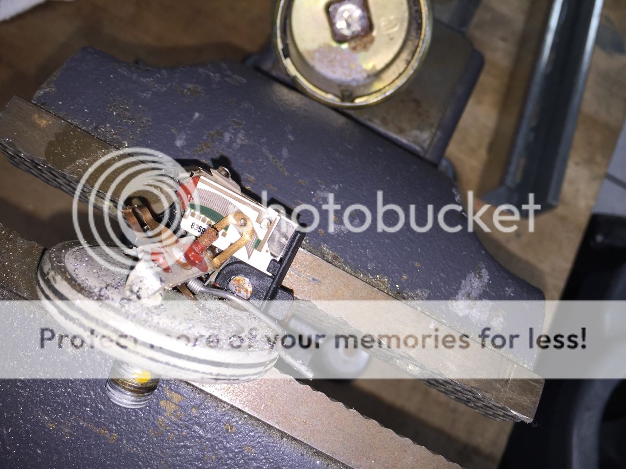

Well I went ahead and replaced the fuel pump today. It?s not a fun job as you can imagine but I will survive. Pulled it out and did a test run and low and behold, I have fuel pressure once again. A little lower than before but it read 4 or 5 psi. Much better than reading zero. So I think it?s all fixed. Just finished safety wiring it. (Yet another pain). I couldn?t do too many of these without a blood transfusion. I will cowl it?s up and hope to fly in the next couple of days.
Thanks everyone for your help. Hopefully it will last another 25 years.
