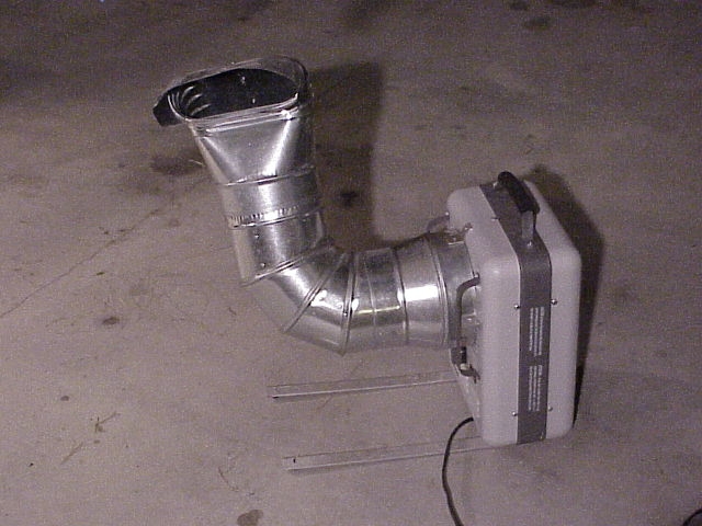

This is my BIG hair dryer. It fits under the cowl and blows warm air where the exhaust pipes are. I leave it on 24/7, keeps the oil 50F reguardless of OATs. I think this milkhouse heater was $20 + $15 for the duct work. Works on any RV.
Patent Pending ;)
Patent Pending ;)
Now we are talking. I see one of those in my near future. My logistics officer has been engaged for the parts and assembly process. Thanks for the picture, I like.

I use the same gray colored 1500W heater and 6 inch duct and "cowl adapter" as pictured in a previous post.
1500w at 24/7 would cost about $110 per month here (elec rate = about 10 cents per Kwh).
