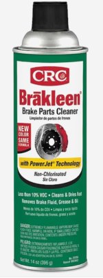

I use brake cleaner. It works great and since it dries real fast, there is no need to rinse.
Buy some when they go on sale and just keep a small stock. Oh, and you can also use it to clean brakes.

As several have said, mineral spirits. While brake cleaner does a fantastic job on all kinds of really greasy, gunky stuff, I would not use it for bulk engine cleaning, as it will take off the paint!
