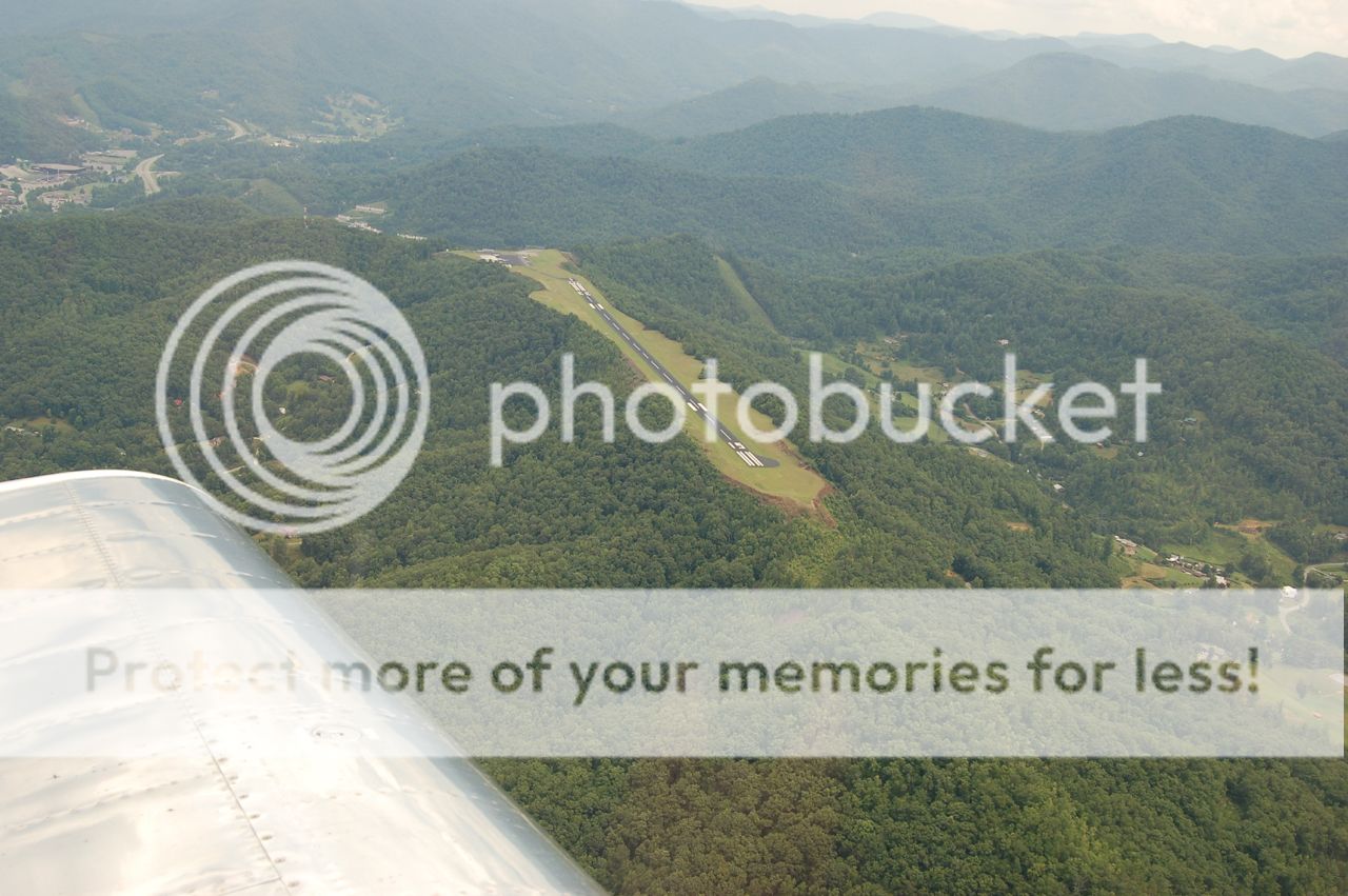

So I see Vlads pics. It really is a blast to fly nap of the earth around here. I like giving an eye level show to the folks eating dinner at the Pisgah Inn :) There are a couple of towers on the ridge south of the field (15 ish miles away from the airport but easily in the "playground") you gotta pay attention to.
