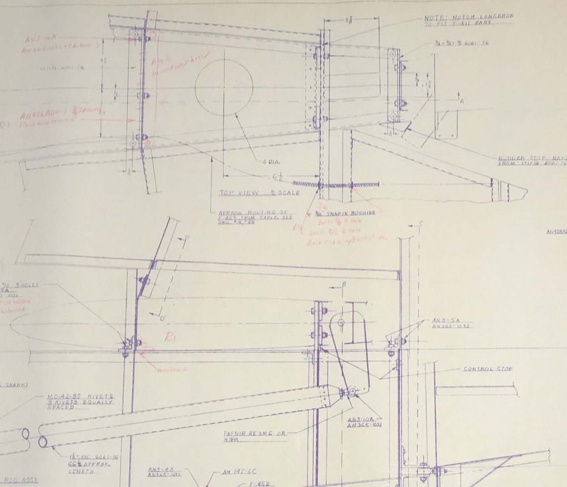

Turns out I now have a couple of version of older plans.
I've been assisting on a condition check on an early RV-4. When we first saw it we were concerned that the original builder had invented his own horizontal stab attach- partially the result of being a little hair-trigger due to all the RVs that have come through the shop with atrociously poor stab attach workmanship. A call to Van's didn't help- apparently no one on current staff was aware of the significant changes that Van made on the horizontal stab attach as the RV-4 evolved, and photos led them to conclude erroneously that it was not to (early in this case) plans. Where is Van when you need him?
Now we realize that what we were looking at was actually a properly executed example of rev 1-ish tail tail attach. The F-410 bulkhead is one piece but the attach angle is behind the horizontal stab spar, not in front of it as in rev 0. My guess is that the RV-4 horizontal stab attach, with its associated split F-410 bulkhead layout that has become the standard layout for Van's tail attach was done because the original RV-4 attach was really difficult to install. Thinking a midget with Gumby arms would've been necessary to get on the bolts that would only have been accessible by shimmying into the aft fuselage head-first.

Found the pic I sent to Van's. This is from plan set #1904. They replied this was an early version on the horz. stab. attach method and was used (and still being used) by early 4s with no problems. This is how my a/c is built. They did not offer any explanations as to why it was later changed. Standardization with later models maybe ?

Original horizontal stabilizer attach design
Here's a snip from a print of the original version of sheet 30, from plans set #68. In this, apparently the original design, the horizontal stabilizer forward attach angle is visible ahead of the spar. If you look closely you can see that the owner of the plans drew the "rev 1" attach angle in by hand, behind the spar.
Seems to me that it would not have been fun to assemble the stab to the fuselage with that design, which I assume is why it changed fairly quickly.
