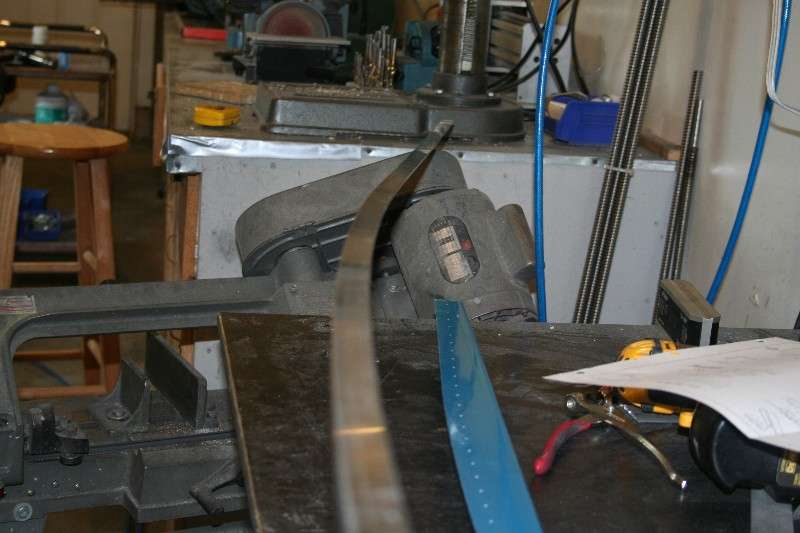

Is anybody else having as much fun with page 23-02 as I am? Bending those fuselage longerons is a bear to put it mildly- my dog has acquired a lot of new words lately! I have a large, very solid workbench and large vise, and it's still no easy task- I don't know how you guys building on a couple of card tables in your garage are managing this task. Steve

Yep, Steve, those are tons of fun. I have a very heavy 6" vise, and it still was no fun to do them. They want to twist at the same time also. You have not gotten to the really fun part yet likely, drilling all the holes in them after you get them bent. I am happy they fit anyway.

While bending you must keep matching it up with the curve of the top piece and that piece has to stay at the same location on the longeron. If youre not careful, when you go to put it on the fuse...all matched up you will find yourself too long or short at the rear end of the longeron where you hook up the tailcone. I just did mine an inch at a time...took it all apart, matched it up, then put it back in the vice...very slow and annoying....but it worked.

Any other words of wisdom? I've been beating these things for 2 hours and barely have 3 inches done. I'm just talking about "flattening" the angles.

This worked well for me and I was able to complete this portion of the longeron shaping in about 20 minutes per longeron.
Like some others, I found the longeron fabrication to be one of the more frustrating and time consuming steps so far in the entire construction. Everytime you think you have the curve right, you find it is no longer flat on top but when you flatten it, the curve changes. You eventually get there by working back and forth a bit at a time!
Just finished my longerons a day ago. See my blog. I tried to open the angle with a 3/4" piece of pipe, scrap angle and the vise, but, it would not budge. Guess my vise is not big enough or the threads are too coarse. Resorted to using a 3# sledge. BUT, put a piece of sacrificial angle on top of the longeron before beating on it. Take it VERY slow and measure each iteration.
Used a press to open up the angle and a shrinker to put the long bend/curve the longeron, it was still a lot of work but a standard shrinker did the job and was easier than the vise. Don't bend the tail end in to much, it will suck the skin in some when riveting. Of course you can always shim it out if needed. Ours did. :) Larry
I went to the local Harbor Freight and bought a BFH (Big Freakin Hammer) 5# soft face. Made quick work of it. When all else fails....get a bigger hammer.

Somewhere in a thread far far away someone made some bending dies out of wood. I took that idea a bit further and built some 6061-T6 dies with my cnc mill.
They worked great bending my RV7A longerons using a fairly heavy 4" vise.
The slot for the horizontal longeron flange keeps the twisting to a minimum and the bend is very smooth. The dies are capable of slightly overbending, so you start at one end and clamp the vise down, relase the pressure, pull the longeron out an inch or so and repeat.

Just to clarify...It is not required that you beat on the angle to get it to bend.
The instructions direct you to clamp the angle in a vise at the location of the bend.
Use one hand to pull the angle in the direction you want it to bend.
Use the free hand to hit it firmly with a soft faced hammer to make it take a set with a slight bend induced.
Repeat as many times as needed.
BTW, my hammer for bending longerons has a solid rubber head that weighs about 1 pound

I will try and explain how I see the difference...
All metal has a certain amount of spring back. Meaning, if you apply a force to make it bend (in a bending break for example), when you remove the force it will "spring back to a lesser angle than what it was bent too. The alloys and tempers of aluminum we use in the construction of RV's has a lot of spring back.
Beating method -
If you clamp it in a vise and begin pounding on it with a big hammer you can get it to bend but it takes a lot of hammering effort and it is difficult to be precise.
Hitting firmly method -
Clamp the angle in a vice with point of desired bent located at the edge of the jaws. Apply a bend force to the angle in the desired bend direction with one hand...with the other hand hit the angle firmly, once, adjacent to the vice. Note, it does not say beat on it repeatedly. If you are doing it correctly it will require one moderate hit and a slight bend will be formed. Slight is all that is needed because you will link a bunch of slight bends together (about 1 inch apart) to produce the large radius curve that is needed.
So what is the difference? I only use a mallet with a rubber head that weighs about 1 pound. I could beat on the angle all day long with the mallet by it self and probably not get it to bend much at all. The combination of the "force" applied with the first hand, and the rap of a light mallet which causes it to overcome the spring back and take a set in the direction you applied the force.
