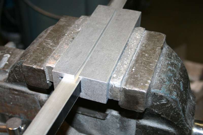

What the longeron dies do.
With which part(s) of the bend are they helping with and how? I'm currently working on it and found it quite dreadful ...
The dies apply equal pressure to the vertical and horizontal flange of the angle reducing the tendancy to twist. The slot that the horizontal flange is in also keeps the bowing to a minimum, but as a result the angle may get tight in the slot. Some grease on the angle helps things out a lot.
[/URL]
Ah, I found it. Paypal transfer completed. I give up after 3 days of back and forth on the center bend on just one longeron. Call me impatient but I can't take this any longer ... When I matched the bend, the vertical plane wasn't straight. After adjusting the vertical plane, the bend was messed up. Come on!
When you bend longerons, clamp them together and bend both at the same time. That greatly reduces their propensity to twist.
With the assistance of a vise (with cushioned jaws) you should be able to knock both of 'em out in an hour.
ws)...... you should be able to knock both of 'em out in an hour.

These things work!
John I bought a set of these dies after I was done with my RV12. After receiving them I can tell you they will make this task a lot easier. For the first time builder maybe not 1 hour but it shouldnt take much more then 2 and no beating with the hammer.:)

Let me copy some text from my blog to share my experience I had with the longeron dies in action. One longeron I abused with a mallet, the other one was done with the dies. The short summary is: I consider these dies at least a recommended tool if not a required one.
"I had finished the left one before and now it was time to do the right one - this time with the help of the bending dies I had received a few days before. A first trial fit session where I used a piece of scrap cut off the longeron showed that the back die (the one without the cut out for the flange) was too tight. I filed it a bit wider and polished it with a SB pad to allow for easier removal of the angle after bending. I also added a marker on both dies that indicate the center line where the bend is being added for easier positioning with the markers on the flange of the longeron.
I was first worried that I wouldn't have that much control over the bend as with the mallet (well, 'control' is not a good word here) as I couldn't immediately verify the shape with the template while the longeron is in the vise. The dies make a direct positioning impossible and I had to remove the longeron after each bend to check if it turned out ok. I did this by clamping it into my second, smaller vise attached to the second work bench. Although this sounds awkward and slow, it turned out to be way superior over the mallet "method". And that is because I never had to go back to a previously bent spot. There's no vertical bend when using the dies. I checked it multiple times and there just wasn't anything to remove! I also developed a good feel for how much pressure was needed to accomplish a certain bend angle and so I hardly had to rebend a particular spot.
After the procedure the longeron looks pretty good. Not like it was salvaged from a shot down plane like the other one did. And it matched the template better than the mallet-treated one, too.
It took me 1.75 hours to bend the center area and the aft 4 degree angle, including the weight reduction cut. Boy, I so wish I had had those dies when doing the left longeron!"

I received my dies this Saturday. On Sunday ( with no previous longeron bending experience) we knocked out both longerons in about 90 minutes. I have previous metal working experience, but the dies make the process quit easy in my opinion.

I did mine according to the Orndorff video and did them both at the same time in a cushioned vice. Worked like a champ and maybe took a little over an hour. I really like the two in the vice trick and measuring between both pieces to get the proper bends. They came out exactly alike and worked great. Just another way to get good results.
I finished my longerons today, used the dies. Sure works easily and speedy, but most of all I got absolute perfection in the bend, matches the armrest EXACTLY! Did not keep track of time, but I would say maybe a half hour total for both.

I thought I would add regarding bending the longerons. Regardless of using the dies or not.
I took the drawn curve on the plan and traced it on 8.5x 11,
that was taped together. Then spray mounted the paper on to a 1/4" peice of luan plywood. With 3m spray mount from a hobby shop. Cut out the curve and used the plywood template to match the curve in the angle alum. Mark the the key measure points on the plywood template.
The important part is laying the angle down on a straight tabel to make sure the bend is correct on two planes. Otherwise twist is a nightmare. I did not use the dies and they came out fine. However, I'm sure the dies save a lot of time in reducing that dreaded twist.

I did my left longeron yesterday and it was quite a challenge --- especially the opening of the angle. I ended up purchasing a 2 lb. hammer and using another angle over the longeron and still have some marks at the vertex. Perhps a bigger vise?
The deformation in the perpendicular plane was less of an issue, although it took a few iterations to get it right.
Had I done the research on the dies, I would have definitely ordered them, but I'm halfway there already. I hope to do a better job on the second one today.
Finally, one thing still bothering me is the tolerances on the twist and angle opening. 0.1 degrees is not for hand tools!
I used a pipe coupling and a (steel) vise. No damage and the opening is easy to control:
Shorter pipe nipple
The pipe nipple can be shortened if necessary to reduce the force required on the vise handle.

Which, as the owner of a ruptured vise, I suggest doing!
Be VERY CAREFUL of overstressing a vice! I did that once straightening some aluminum angle and had the head of the vice break. Because of the tension, it flew--within and inch of my face. It landed 23 FEET away, outside the garage, through the open garage door. It still scares me to think of it even now. I will never again own a cheap vice.
Bob Kelly
I had a similar experience with another cheap trick. When opening up the angle, I chose a nice (slick) deep well socket. Worked like a charm, crank down on the vice, and the angle appears like magic. Suddenly however the socket slipped out under pressure, shot a nice hole in the garage door insulation, glad I was not in its path.

Tried a shorter nipple with the same 6" vise. It was a struggle, but the angle finally yielded. I believe I came close to breaking the vise!
Getting the right curve was another matter. I did get it within the 1/16", but this is much too big a tolerance for the .020" skin thickness. After 4 hours of bending in both planes, finally decided it was good enough.
What worked for me was drilling the ends, clecoing, drilling the middle, and then the rest of the holes. It ended not perfect, but close.
So far, this has been the biggest challenge in the build.
