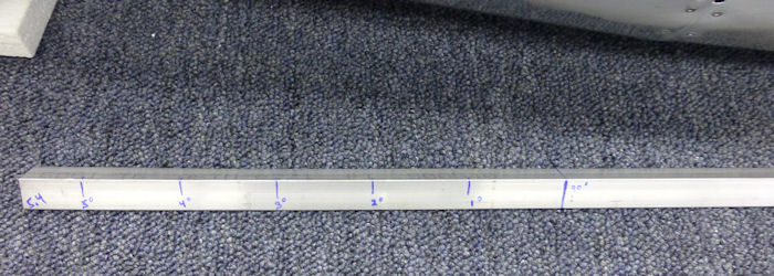

Is the idea to start with a 5.4 deg opening and gradually taper that to zero at the "End of Twist & Open point (12 11/16") or to have a constant 5.4 deg from start to end of the Open section?
Taper
Ideally, you want to start at 5.4 degrees and taper to 0 at "end of twist and open". The instructions suggest a gradual taper if I recall ... which I missed at first.
My flair goes most of the way before I caught that. Still works but a critical eye you can see where the flair stops.

Did mine not too long ago. It's 5.4 deg for most of the way and then gradually taper as you get to the last 6 - 8 inches.
A few of the things I learned while doing this.
1. I was not able to get the "hammer method" to work at all.
2. Tried using an 1-ton arbor press but it didn't produce enough force.
3. The cheap HF 6-ton hydraulic press worked great.
4. I did not use a piece of pipe under the angle while pressing down - I should have.
The reason I didn't use the pipe, is because it rolled while I was pressing down so I could not keep it centered. Find a way to secure the pipe in place or flatten one face so that it doesn't roll.
Without the pipe, the faces of angle develop a curve. I had to go back and re-flatten the faces.
When you get to the next step of twisting 2.7 deg, the point is to get the top face back to being flat along the entire length. The 5.4 deg change will all be in the vertical plane.
Actually it is 5.4 degrees open at the fwd end and then gradually tapper to nothing, over the entire portion of the angle.

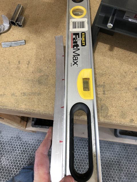

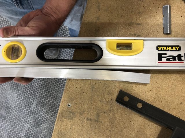

Opened angle too much
Oopsies. I misread the instructions and opened up the front of the left longeron to 95.4 +/- 0.5 through the first 12 inches. Now it looks like I need to close it back up some (or maybe buy some more material & start over?). How do people close the angle when it's been opened too far? Bench vise? Vise grips?
Okay, Plan B: I'm going to salvage the piece by making what was to be the left-front longeron the right-rear longeron and start the left over using the angle set aside for the right side. Thank you Joe for this very helpful photo:
Longerons
