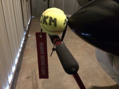

Anyone close to their RV12 today, would you please measure the distance from the spinner grommet to the end of the pitot tube.
Thanks in advance
Length of Pitot Tube
About 15/16" or 23.5mm, probably 1" nominal
By grommet, I assume that you mean the bearing.
Joe, as one of our inquiring minds, have you given any thought to what would be the effect of making that length shorter, say, 5/16".
From time to time I brush against mine on the way to unlatch the hangar door on the far side.
Shorter would make the contacts less likely with less stress on the tube.
I had that problem too, until I started using my pitot cover.
Be Careful.....
You might try experimenting, but if you get it too short you may start picking up the boundary layer around the spinner.
I do not know the affect of making the pitot tube shorter. I do not think that shorter will prevent injuries. It is just a matter of time and becoming complacent. You could move the pitot tube to the wing. While still potentially dangerous on the wing, that area gets a lot less foot traffic.
