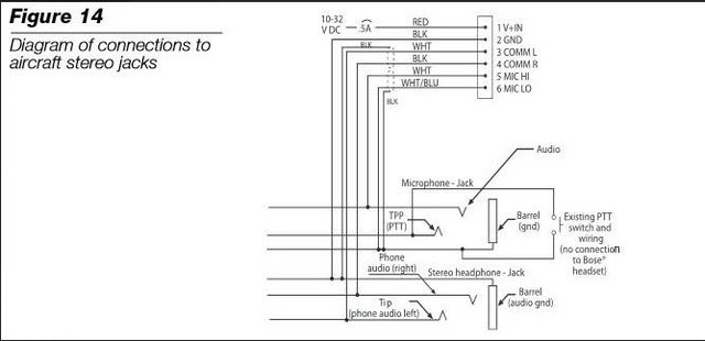

The other question is regarding wiring a Bose A20 headset to the Garmin GTR 200 using ONLY the Lemo Jack without the GA plugs. Neither garmin or Bose were able to help me. Of course the only post that said that they had just what I needed was not there anymore. Thanks, Rich

Sergio- I thought about this and did install both plugs for the passenger. I just want to keep it simple up front and only have the LEMO. I have the adapter for LEMO to GA. All of the literature included with the LEMO shows it connected to GA plugs. I am NOT an electrician or avionics tech and would be more comfortable following a schematic showing only the LEMO to GTR 200. As I mentioned; no help from Garmin or Bose.

My question is how to wire ONLY the LEMO jack for the pilot. No GA plugs involved. I can make a good guess as to how it would be done by looking at the GA/LEMO schematic but I don't want to guess.:confused:

Connect as recommended BUT leave out the GA jacks. The signals are the same but the GA Jacks are left out.
Here is the wiring. Do NOT connect the GA Jacks to give what you want.
Page 35 of the BOSE A20 manual show the wiring of the LEMO Jack. Page 36 shows the wiring with GA Jacks that are Stereo and Mono.
It does not matter if you are not using a BOSE headset in the LEMO jack, the wiring for LEMO jack is the same for all manufacturers.

The LEMO plug make it simple and it does it all. Phone, Mic, and ship's power for the ANR. Bose makes a LEMO harness which makes the wiring neat and tidy. If you already have standard jacks then you can add the LEMO harness and tap into the Mic and Phone jack.
