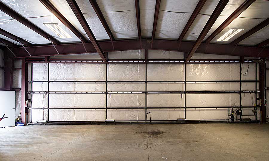

So I purchased a hangar recently :D
One of the improvements I would like to do is install a fixed vented propane heater.
Because I will be renting the hangar out until I am ready to move my -7 project into the hangar I applied for a commercial lease. Oregon requires a commercial lease if ANY revenue is being made off of the hangar.
Anyway, while researching heaters I came across NFPA 409. This states that heaters must be at least 10' above the wing of the aircraft.
I might get the heater 10' above the wing of my -7 but the rule says 10' above any aircraft that can fit in the hangar (I'm paraphrasing). Not happening :(
I read all about portable heaters...I'm interested in the fixed variety.
So, Do I have to comply with this NFPA 409?
What is everyone else doing with hangars with lower ceilings and heat??
The top of my door is 12', the door opens to about 10' 8"... No way to meet the rules as far as I can see :eek:

I?m not an expert in such things so be sure to verify my thoughts... but in reading the standard, section 5.12.2 requires open flame heaters to meet the 10? requirement of section 5.12.5. If you use a closed-flame heater, section 5.12.5 does not apply and you can install the heater below the 10? minimum. From what I understand, closed-flame heaters don?t use room air for combustion (they use outside air), so the explosion risk from fuel vapor is lower in the hangar... I assume that is the reasoning for the regs being written the way they are. I was reading the 2016 version of NFPA 409 if that makes a difference
If the rule is inflexible, you could do an end run around it by installing a 'packet' style central unit just outside the building. You don't need to run extensive ducting; just get the outlet and return through the wall or roof. One upside, if it's on the ground, is simpler maintenance in the future.

This may be the way I go if I find out a closed flame heater is exempt from the 10' rule.
I'm looking at the section on Class III hangars 8.3.* but the verbiage is identical to the Class II section your referring to.
I'm hoping you're correct that the 10' rule only applies to open flame heaters.

Consensus Standard
The NPFA Code is a consensus standard. Unless your local municipality has codified it locally, compliance is voluntary. Check with your local building code inspectors or FD to see if the NFPA code is binding. However, compliance is usually a good idea.
Thanks, this was the best answer yet :D
I just googled "is NFPA standard binding?". Apparently it's not :rolleyes:
I'm pretty sure my locality has not codified the NFPA standard.
My main concern, besides the NFPA standard, is that my insurance company agrees the installation is proper. I bet they'll be happy if the installation meets local codes.
Be a bit careful. The AHJ (authority having jurisdiction) can be city, county, and state. It can a long, circuitous path figuring out who the AHJ is, along with what version of the code that is "law".
