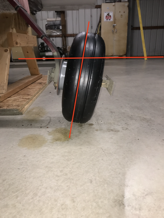

I’m in the middle of my Annual Condition Inspection and replaced tires and brakes. With airplane raised up, it is a real eye-opener to see how much camber angle is built into the landing gear. I measure 11 degrees camber…

For Camber adjustment - I'd simply look at the tire wear pattern & let that dictate if you need any shims.
