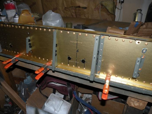

Labeling
I agree the labels will show through. When you label is the question.
I peal vinyl, clean with laquer thinner to remove any glue residue, scuff a small area where the label will go then use sharpie to mark the part. The labels are very small with a fine tip sharpie. When it's time to prep for primer I don't scuff the label area. Primer prep cleaner doesn't remove it and it shows through the primer. I use SW P60G2 so you may not need to scuff. I also use arrows on labels. Two lines at a right angle with arrow points. One points forward or up depending on the part and location. One points inboard. I also label where two parts will mate so the labels never show. When parts are assembled, no labels are risible. YMMV

I just ordered a set of numbered metal tags and used safety wire to attach them to the various parts being treated.
Michael,
The sharpie will not survive the acid prep.
I know of no better labeling than metal tags.
metal tags
Gents, that's perfect. It's what I suspected.
I have a stamping kit from Lee Valley so I'll get some metal tags and wire and get stamping.
Thanks a lot for everyones suggestions.

I found that depending on the primer, sometimes, the Sharpie will bleed through, so that you can see it. FYI, DO NOT use black Sharpies, as they contain a carbon compound [for pigment], which can cause corrosion down the road. Remember, it's under the primer. Use any other color. I used Sharpies [blue or red], then wiped them off with lacquer thinner and applied the paper tags prior to etch, Alodine and Epoxy priming. After the primer dried, I wrote the ID numbers with a Sharpie and removed the paper tags.
The downside to leaving holes un-drilled, is that you must either deburr the holes later, which removes the Alodine and primer. Or you are riveting parts together with burrs on them. Neither is ideal.

I was also looking for an easy way to label parts that would survive the cleaning and priming process and I came up with something that works well for me. I found that I prefer to prime the parts before dimpling them since it makes it a little easier to prime the parts and dimpling doesn't seem to affect the primer at all. But it's really not a big deal one way or another. So I started dimpling a unique pattern on each rib before priming to identify them through the priming process. Dimple the first hole for the first rib, the sixth hole for the sixth rib. One dimple somewhere else to note left or right side. Pick any pattern you want. If you prefer to dimple before priming, then do the opposite and leave a few undimpled holes in a pattern during the priming process. Works great for me and I don't have to worry about keeping track of parts while I'm cleaning and priming.

The electric pencil does not "engrave", that is, it does not remove metal. If you look at it with a magnifying glass, it is just a series of very small spherical dimples in the metal. The bit in the tool is not sharp, but is rounded, about the size of the ball in a fine-point ballpoint pen.
As for the black ink in sharpies causing corrosion, it must take more than 16 years for that to happen. I marked some RV-4 parts as long ago as 1998, and there's no sign of corrosion. Even if the ink has carbon in it, it will be sealed up under the primer, blocking the moisture required for an electrolyte.

I have been using little numbered tags that I made to identify parts during the coating process. Occasionally they will come loose in handling (and I only have so many of these) and I'd like to try another way.
This thread, old as it is, and a couple of others, reference Van's Aircraft's use of vibrating peening markers and supposed approval of such in the construction manual, but the newer versions of the manual make no mention whatsoever of this.
My spars and center section were marked by the factory with this kind of device, but they don't seem to endorse it for our use anymore. Is there a reason for this?
I sure would like an easier marking method than these little tags...and Sharpie's not an option for me because the solvent wipe completely removes those markings for me.
