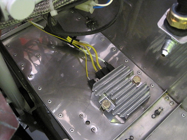

I have a total of 165 hrs on the airframe, which means I have approximately 50 hours on this installation. Everything is working great up to this point. Here are the pictures of my installation.

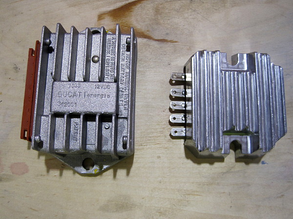

The two regulators side-by-side.

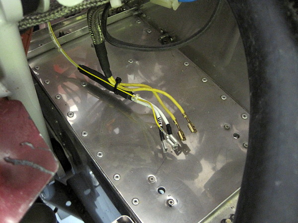

I used my wiring tools to remove the clips from the Ducati clip.

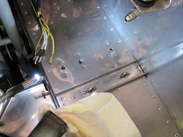

I drilled a new mounting hole and installed a nutplate. I probably could have made a mounting plate and avoided the new hole.
Regulator mounted and shrink tubing used to hold the clips on and to insulate them from one another.

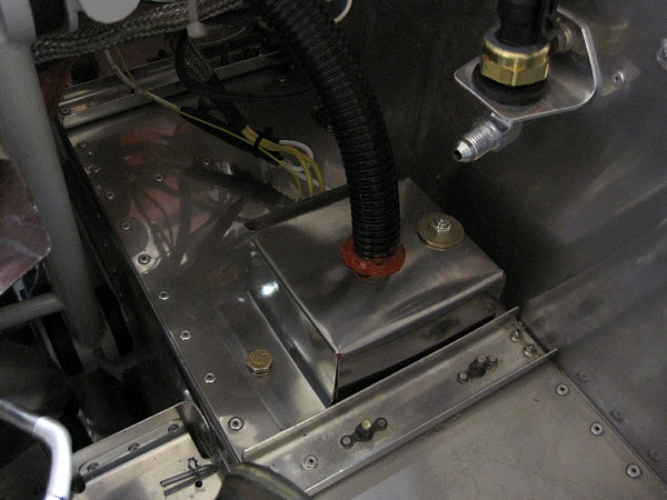

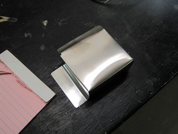

I made a cover that allows for about 3/8" airflow around the regulator. This also acts as a heat shield from the outflow of the radiator and the exhaust pipe.
Cover mounted. The nut and washer cover a hole I had to drill to get at the back bolt. Poorly engineered I admit but it works.

Here's what I recall. The JD regulator has one less post on it than the Ducati regulator. There's no "R" terminal on the John Deere. That means one of the heavy white wires is not used and can be tied off to the wiring bundle. They come from the same source anyway so it doesn't hurt anything. Be sure to cover the end with some shrink tubing to insulate it from shorting out against the firewall. The remaining heavy white wire is connected to the "B" terminal. Also, on both regulators, terminal "L" is not used. I think it is used to drive an indicator light circuit. The two heavy yellow terminals come from the generator and are connected to the two "G" terminals. Doesn't matter which wire to which terminal. The remaining small yellow wire connects to the "C" or sometimes labeled "F" post. This is the bus voltage detect wire from the ignition switch.
Permanent magnet alternators (dynamos) do not have a field winding and thus no "F" terminal. The "C" terminal on the Ducati regulator serves a dual purpose: it is an on-off control and also bus-voltage sense. The regulator monitors the voltage on the small yellow wire that comes from the master switch. The Ducati regulator adjusts its output to maintain a system voltage of about 13.8 or so, at least on my plane.
The John Deere AM101406 and MIA881279 terminal "IGW" corresponds to the "C" terminal of the Ducati. I have not installed a John Deere regulator on my RV-12 because the Ducati has not failed . . . yet. But I did replace the regulator on my Simplicity lawn more with a John Deere and its output is 14.2 volts, which is higher than the Ducati. Most aircraft and automotive regulators are set at 14.2 volts.
