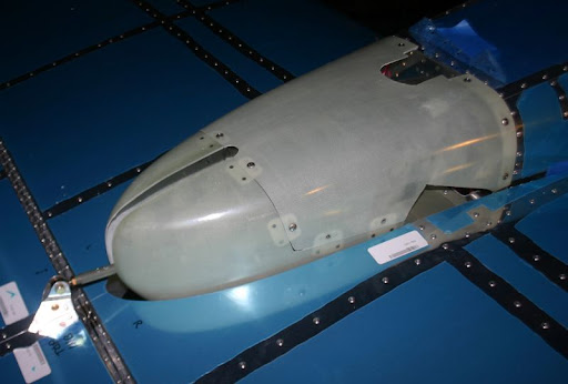

Jim, Photo #6 shows 5 rivets on the aft verticle stabilizer spar (center of the picture) that have not been riveted. I found the print does not instruct us to rivet these. Clearly, they should be riveted with the blind rivets. Also, behind the rudder (aft vert stabilizer spar, again) did you rivet all of the holes yet? There were about 30 that had not been riveted when I got done. I re-read the plans and could not find where it says finish rivet all holes. I pulled the rudder and finished it up.
Any thoughts?
Any thoughts?
Good catch! I just figured that those holes would be riveted when the tail cone fairing was mounted. I will check with Van's before I rivet them. BTW, I got my fairing when I picked up the kit.
On another point, be sure that you mount the fairing far enough forward to allow it to clear the stabilator. If it does not clear on the side, you can us a heat gun and some wedges to bend the side in a bit. Carefully heat the fairing top and bottom and then push a shingle or similar wedge between the fairing and the stab. Let it cool for an hour or so and it will stay in the new place.
Check the rudder attaching spar also. I found about 30 rivets that were not called out to be riveted.
Any thoughts?
I just talked to Gus at Van's and he said that the plans should have had you rivet those when the skins were riveted on. Same for the other holes.

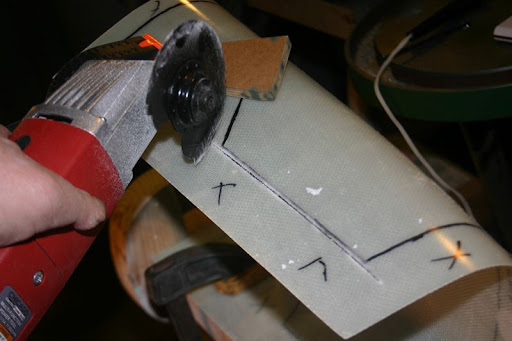

So while waiting for my fuse, I decided to do the fairings. I first tried tinsnips (yuck-crushed it) and hacksaw. The hacksaw slid around and scratched it, and a sabre saw was too wiggly!
I bought a clone multi-tool from harbor freight, and it really did well. It has a powerful vibrating action and I could slot the fiberglass and then cut it.
Afterwards, I used a moto-tool with a sanding drum to get close to the scribe line, which I darkened with magic marker.
Does anyone know if they are good for cutting canopies? I think they are safer than an abrasive wheel, they kind of work like a Doctor's cast saw.
On my airplane, the aft split part of f-1294B almost touched the stab, so I moved the top forward about 3/16". I then had to expand the spar box cutouts and the rudder horn cutout. It might have been better to slide the whole thing (top and bottom) forward. They are really nice parts.
Then I read Jim Cone's post and he saved me from putting the nutplate in thin air. Thanks!
John
John
Did you double check the clearance from your rudder before committing to this?
The rudder clearance to the tail cone fairing is quite close.
