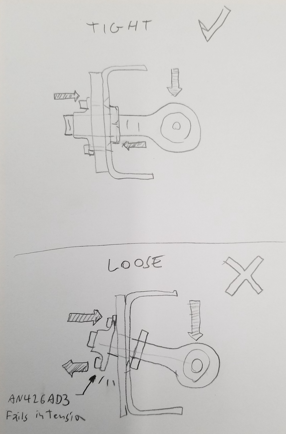

The temptation might be to look at this as an issue of the jam nuts preventing the rod ends from unthreading themselves. You'd see that the angle brackets on the stabilizer prevent the rod end from turning very far, decide that the jam nuts have no particular purpose, and carry on.
However, what the jam nuts actually do is apply clamping pressure that helps transfer bending loads from the shank of the rod end into the control surface of the spar. In the absence of this clamping pressure, all that's resisting the bending loads are a couple of wimpy AN427AD3 rivets, and these rivets react the bending loads in tension. And rivets, especially when there's only one or two of them, are not all that good at reacting tension.
Once those tiny rivets break, the control surface has a lot of play to move out of plane. And that's very bad from a flutter perspective.

Most excellent drawing to go with explanation. I have sketched many such drawings on my whiteboard to visualize what is really happening.

Given that explanation, wouldn't a regular washer under the jam nut be a good idea?
Actually, given that these jam nuts seem to be famous for loosening up (and often not being caught by the owner), wouldn't a lock washer under the jam nut be an even better idea?
On the other hand, I think the jam nuts on my tail control surfaces tighten down onto painted surfaces, and I guess a lock washer would bite into and screw up my paint, opening a pathway for possible corrosion - which wouldn't be good. A lock washer on top of a plain washer then? I bought my plane already built, so I may be missing something here(?).

OK Vic, Can you please educate me. (You know I was a buyer, and not a builder) Could you maybe make a drawing or take a picture, first from a distance, (so I know where on the plane you're talking about), and then up close, so I know exactly where to look??

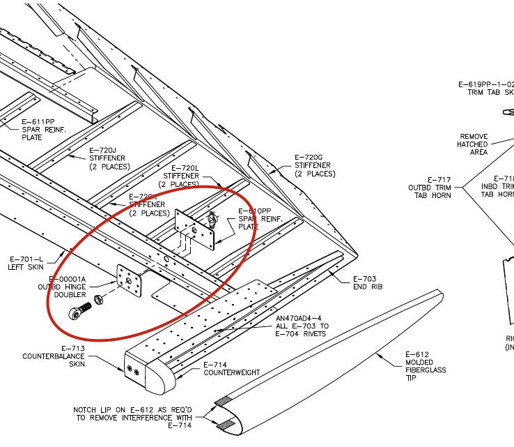

Here's an RV-8 elevator picture from the plans. I've marked where the hinge is. You can pretty easily see where the rod end is, the nut and the nutplate. Although I'm building an RV-3B, this design is common for all the RVs that I'm familiar with. And besides the elevators, the rudder uses this design, too.
Also, thanks, Bob, for your clear explanation of how and why this design works. It's a good example of one of those subtle details that aren't actually all that obvious.

The forces involved on the joint are quite different as the sketch in post #2 of this thread shows.
