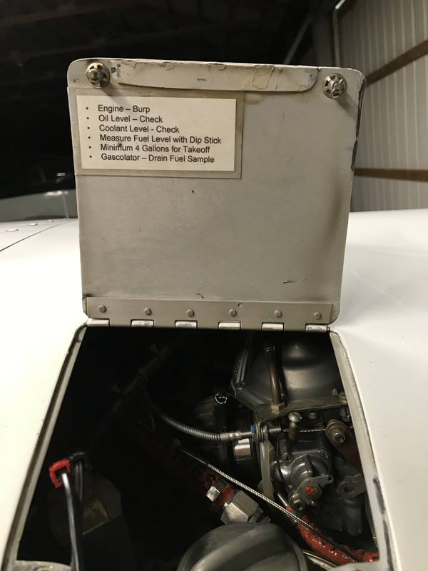

I made an abbreviated checklist for engine items and fastened it to the inside of the cowling oil door.
A good reminder as you're "staring into the void".

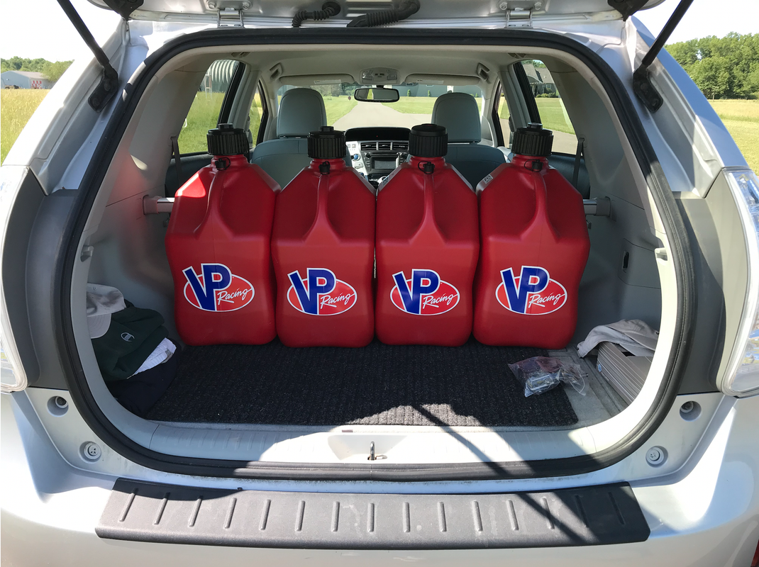

I filled four jugs of fuel with 6 gallons each and took to the airplane this morning. Fuel is a very heavy commodity. Maybe lifting the fuel jugs is starting to show my age. Gives me a good appreciation for how hard the 100 HP Rotax is working when it can lift airframe, 20 gallons fuel, me, and the wife at 1000 FPM climb rate.

Is this safe?
Not knowing much about handling gasoline, I have to ask: Is this considered a safe way to transport 24 gallons of fuel? I drive a small hatchback, so in my car the jugs would be even closer to the rear of the car than what is shown in the picture.
I have a Costco 1.5 miles from my hangar, where I fill up. I'd be fine with that setup to refuel. I might strap the jugs in so they can't fall side to side or fall over, front to back, but that would be about it.
There is a very stout crossbar made of extruded aluminum that the jugs are pressing against. I think its pretty safe - certainly no worse than if jugs were loose in a trunk. I drive extra careful and take back roads when delivering the fuel approx once a week during flying season.
Jim,
I have 4 five gallon fuel containers. I only put 4 gallons in each one because I am an old man and it is easier to lift 4 gallons. I also have a personal rule that I never land with less than 5 gallons so 16 gallons has always been enough fuel to fill the tank.
