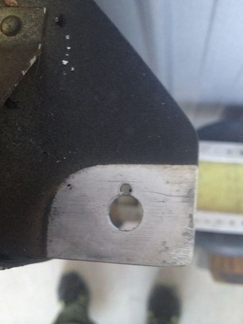

I just pulled one of the wings off "Dusty" and the rear spar has been misdrilled. The attach point where it attaches to the fuse has a small hole next to it. See pic. Anybody know how I could fix this or is it a problem?

I would refer that to the Van's engineering department for evaluation, when it comes to primary structure what "the brain trust" thinks doesn't really matter.
Been there done that. Vans answer is it should be fixed. It really isn't as bad as it seems though. Only 2 doublers need to be replaced. Total job took me about 15 hours

Why are there so many sanding scratches and other marks on the part? Did they grind/file/sand on it too?
The deeper gouges might be from trial fitting into an equally poorly finished spar pass through. The lighter sort of mangled looking lines around the hole are mill marks. These spars where made from raw bar stock. I spent days sanding and polishing out these mill marks before I primed and assembled them. Honestly, not sure if it makes that big of a difference but....

[/URL][/IMG] I encountered the same problem on my -4. I emailed Vans and included the photos. Their response was replace the rear carry through spar and the attach point on the wing. This is unacceptable. I believe they told me you needed 5/16" clearance around the hole. It's an easy fix. The downside is you have to redo the wing sweep and incidence.
Could the bolt hole not be enlarged to include the smaller pilot hole and use a larger bolt?
It wouldn't be easy to but would be easier than replacing the rear spar carrythrough.

Edge distance might bite you.
If you could accurately bore the hole bigger and put a bushing in while maintaining the recommended edge distance it might work but that's hard to do on the airplane. I'm flabbergasted that somebody built that and went and flew it. Wow.

Second, ask Van's if you can have someone weld the hole close and then re-drill it.
Referance
Save the effort - no way can you weld this and retain enough strength to be safe. Not a chance.

There is an AC43.13 reference that advises not to heat aircraft grade aluminum past 212 degrees to prevent adverse effects on the temper.

You can weld castings and thin sheet used for fairings and non structural parts but not on something like this, where the strength comes from the heat treatment.
Thanks guys. I will contact Van's just to get there two cents, but I think they will agree with you guys. The only way I see to fix it without replacing the whole piece is to updrill it. I will have to check on the edge distance on that. Does anyone know what is allowable?

He is a lucky guy i would say....I wouldnt knowingly fly it for 5 minutes with that notch in the rear spar attach hole. Cant tell for sure but it looks like they just riveted a small section on where the hole is vs the complete doubler?
I would look at the bolt holes attaching the empenage too. If the qualty of that hole didnt matter to the builder I would be concerned about other critical points. Did he build the spar?

The rear spar is loaded entirely different than the main spar. It carries drag and twisting loads, and carries near zero bending loads (that's why there is only a single hole). There is a plate doubler at the inboard end of the spar that could be replaced if absolutely needed. It does not run the full length of the spar. The little "snowman" hole can likely be plugged. I deal with these scenareos often at my day job on big jets, and you would be surprised at the answers we come up with in engineering.
The RV8 has a very specific edge distance requirement on the aft spar attach point. 5/16 absolute minimum IIRC. Vans plans instructions identify this as a critical dimension. I expect them to tell you the same about this and require a replace or repair to meet the design strength. I believe they have now developed a repair procedure that allows something short of replacement. But this aircraft must be repaired per Vans procedure to be airworthy in my opinion

I am not surprised. In fact, I would suggest this could have flown this way for it's entire useful life, through the full g load range, day in and day out. Edge distance is still there, there is no sign of a crack developing, and the main hole looks as if it has not been wearing.
However, it is absolutely not acceptable in my mind, not because it may fail, but because it simply isn't right and I would not accept it. Van's would be crazy to accept it as well just from a liability stand point. As mentioned, you are not the first and this can be easily, although a bit time consuming, fixed.

When contemplating a repair plan on an important structural member, it is usually valuable to have some understanding of the load path.
It would probably surprise most builders to know that the highest load on the rear spar joint is a tension load resulting from the wing trying to sweep fwd.
This occurs at high G, high alpha (critical angle of attack)
It is what is evaluated when testing in condition "D" for compliance with FAR 23.
It is also why vertical edge distance on this part is so important.
In the photo posted by the OP it looks like the edge distance on the clevis portion of the joint (on the fuselage) may not meet minimum edge distance (based on the paint/primer line visible). The extra hole in the rear spar, though not compromising edge distance, would be an undesirable stress riser, and is reducing the baring area for the bolt in the vertical direction ( the next highest load path).

I talked to the guys at Van's today and they said definately replace it. The comment went something like this, "When we saw your picture it was kind of like having a black cat cross your path.". They also added that it won't be big deal to replace. In the grand schemes of things really is a day's work and a few dollars worth risking your life?
