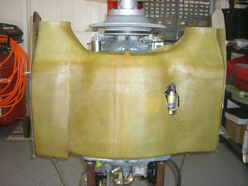

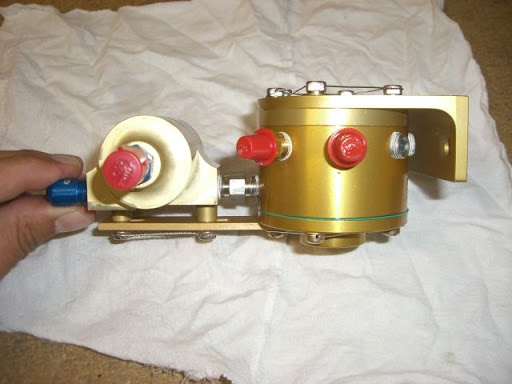

I am trying to get my purge valve to fit under the cowl/plenum and just cant do it with the configuration shown below. Are there any fittings less than 45 degrees that will fit between the spider and the purge valve?
Not to my knowledge.
I've seen straight, 45 and 90 degree, but never anything in between.
I even checked my new "Genuine Aircraft Hardware Co" catalog.
Ditto
I looked in the Aeroquip catalog and they have the same that Mel referenced. No dice. Looks like you may have to get creative.:eek:
Getting creative
You can get any angle you want if you can tolerate a lateral offset. Use two 90 degree elbows, one with a male NPT port and the other with a female NPT port. Mate them together and stop the final turn at whatever angle you want.
On the sj plenum you have tocut a hole and make a bulge. There is plenty of room for the purge valve this way
Frank
Frank

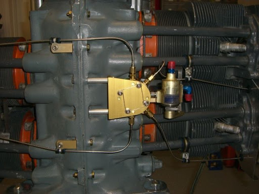

I did that however, my engine is a narrow deck so the spacers that came with the fuel injection kit don't work. I had to make longer spacers, that moved the purge valve further outboard. My cowling sits right on top of the valve. I refuse to put a blister patch on my cowling. So I have to find another way.
How about.....
....Putting a braided teflon hose on it and remote mounting it where ever
you want?
Could remote mount it but
the further the valve gest from the spider the less well it will work.
Any chance you could remake the the bracket where it bolts to the engine such that it angles the the whole thing downwards?
Come to theink of it I think I make have even chamfered the alu tubes such that it angled the whole thing downwards myself. You don't need much angle as the assembly is quite long.

So if you really want a 30 degree fitting..Simply remove the fitting thats there..Go down to your local hydraulic hose emporium and buy the same thing in steel (as opposed to stainless steel) cut the thing in half at the middle and grind a 10 to 15 degree angle on each cut face.
Then simply weld the two halves back together.
I have done this several times when I made fittings for my wingroot fuel pump system.
Somebody who is good with a TIG could probably do the same thing in SS, but I gas weld and carbon steel is what I'm comfortable with.
Of course you will have to adjust (or make new) the connecting bracket.
Perfectly feasible..if your not in a hurry you could cut it, send it to me and I'll weld it back up for you.
Frank
Talked with Don. He said I can remotely mount it on the other side of the engine (great idea). He said an 8 inch line or so would not make that much of a difference. By the way if you mount the purge valve remotely, you don't have to use stainless steel fittings. Alum AN fittings work fine. Don't ask me why. Thanks to all for the ideas.

Have to go home and look but I will have to make some type of attachment just like the one for the spider/flow divider. I may be able to install the purge valve in a way that will make it easier to attach the control cable to it for operations. Have to go look at it some more.
My guess is with the length of the valve arrangement you won't need anymore than a 10 degree droop. The make a little bracket to hold the cable shroud with an Adel clamp and you'll be set.
