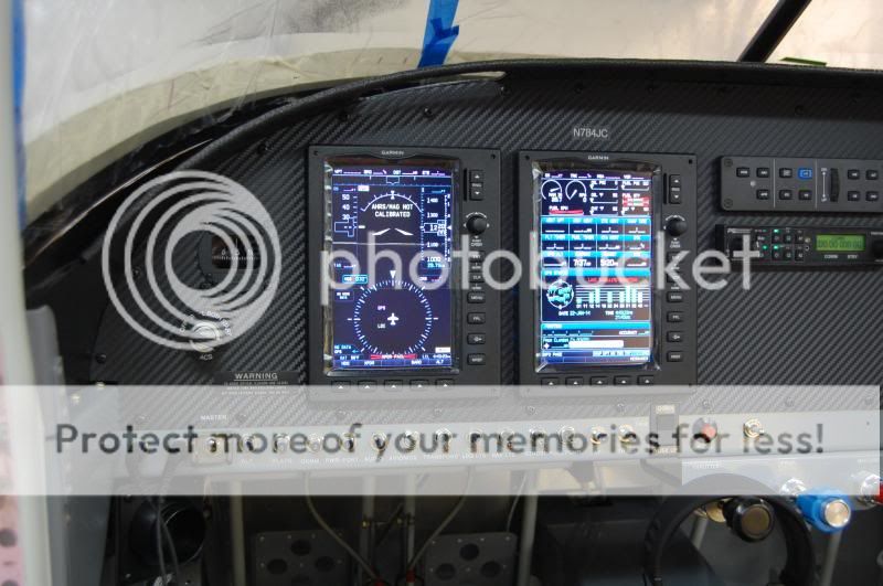

My RV-12 panel came out looking just like Joeri's in the above picture. I used the dark gray version of DINOC instead of their black version. Like Joeri's, my diagonal patterns all nicely aligned at the joints - however in my case that was more luck than skill! Also, you can judiciously use heat to wrap the edges and corners - beware however, your wife's hair dryer might be a better choice than the lowest setting on a heat gun - do test samples first.

Joeri, is that a carbon fiber applique or vinyl or something else? The whole effect, including the joints, is very nice ...
Hi Tom,
It's also the 3M DINOC vinyl. Works great. To make it easy you will need a heathgun and a sealing iron for e.g. monokote (model aircraft). Like mentioned earlier it's best to use plastic washers underneath the screw heads otherwise the vinyl will damage.
Joints take some time, but easy to do. Peel off a little strip of the protecting film and stick to the already done panel so that the pattern aligns. Put the next instrument panel underneath, remove the film and your done.
