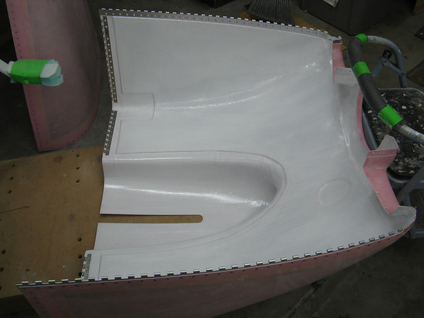

Three coats of white tinted epoxy (West Systems) with a tiny bit of acetone to thin looks like this after being rolled/brushed on.
Nice hard shell coating. Good visibility of any drips/leaks. Easy to wipe clean with some soapy solution.
This is before laying down the reflective aluminum and heat shielding from Van's.
