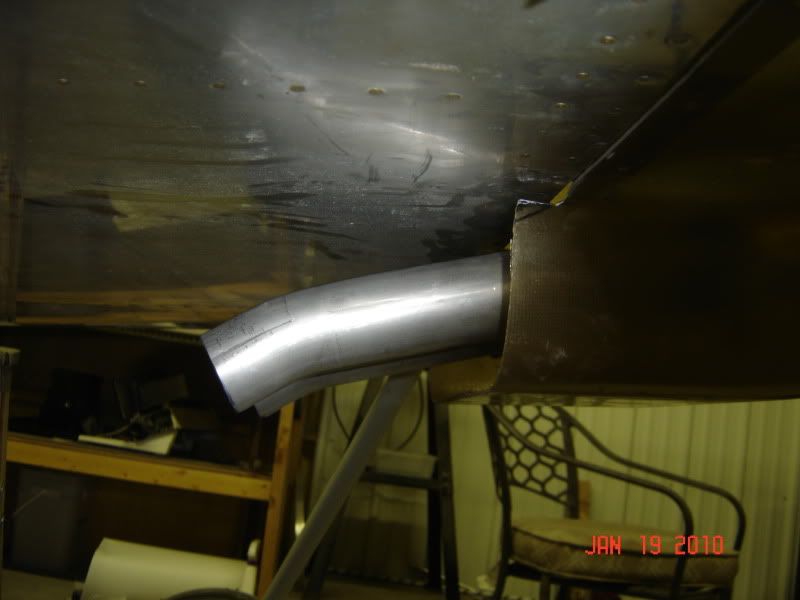

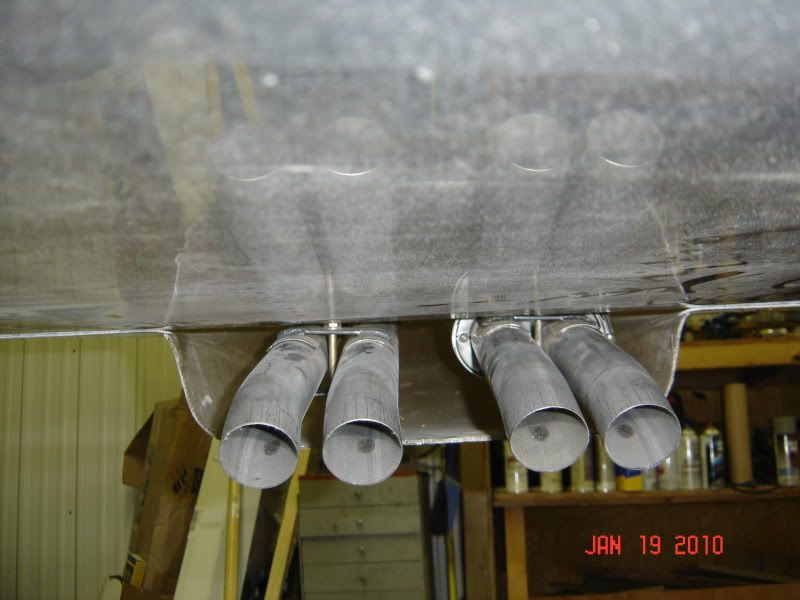

I'm working on my cowl and baffles. I'm using a James cowl and plenum set-up. I have calculated the inlet area of 33.6sq.in. and the outlet area of ~37sq.in. So the ratio comes out to about 1 to 1.1.
The 4 pipe system sticks aft of the firewall about 6". I didn't cut the lip off the cowl outlet and it extends aft about 1".
I have read the threads discussing outlet velocity and seen the pic of tufting the area aft of the outlet.
So my question is: Is it worth the trouble to reshape the outlet to reduce the ratio a bit or do something to the corners to help streamline the exit area flow?
From my research, unfortunately, there is no magic inlet/outlet ratio as there too many variables in individual building design. For some 75% work for others 180+ work.
I think reworking the square outlet is well worth the effort in that is has been shown to be a flow disrupter.
Just remember that we want to speed up the exhaust air to as high as posssible, resulting in lower pressure and better transition to free stream air. Also you want to make that transition as smooth as possible, and the stock square is not the best for that.
Reworking the square outlet is what I am thinking about.
1. extending cowl AND at the same time tapering it towards the center.
2. adding a bump aft and above the pipes, something like L Vetterman added to his -6a.
3. cutting the pipes to get them out of the airstream
Looking for opinions. what do you racers out there think?
I may just try to get this thing flying and then make the mods in order to evaluate them.

Brian,
IIRC, Sam James told me that the ratio should be 1:1. This way air is leaving the cowl just as fast as it entered it. The air enter at 170+mph, slow down so 15-17 mph as it moves through the baffle needs accelerates back up for the exit.
Sam is always willing to talk shop, pick up the phone and ask him. If you can't get a hold of him, I see him once a month. I'll print out your pictures and ask.
If you're looking for speed, I'd cut those pipes down since they're adding drag and long as there is not some unintended consequences.
