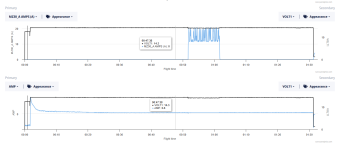

On a recent flight I elected to validate my Monkworkz MZ-30L standby alternator by running it for a few minutes with the primary alternator off for ~10min. During this, I kept an eye on the MZ-30 current output, as reported by the MZ-30 voltage regulator proportional current output (pin 5) wired into my Dynon EMS/EFIS. The results were odd, with the system reporting a peak to trough current measurement delta of ~7.5A. For the first ~5min I didn't change anything electrical with the aircraft (strobes on, beacon on, everything else off). I switched both the strobes and beacon off at ~7min into the test and observed no change.
The MZ-30 is wired into the secondary 60A ANL fuse, plus has an inline fuse itself. The primary fuse has the B&C alternator tied to it, and the current shunt on the Dynon is connected between this and the main contactor. If I understand this correctly, it is really a battery meter, and doesn't show actual load on the avionics bus in flight.

Any and all thoughts are much appreciated!
Is your proportional current calibrated? It's a small voltage range, maybe also check the ground reference for that voltage, make sure it isn't loose.

Many elec appliaces are quite variable in their load. Strobes, for example, initially draws 3-5 amps and tapers to almost nothing every second or two. Every time you key the mic, it may spike 3-5 amps; transponder similar. Most ammeters agressively smooth or average out the readings. Very possible the monk doesn't do this kind of smoothing and are seeing more of a raw, unadultered feed.

That is what my initial thought was, but also hoping to learn something from this. The transponder current makes sense to me (I'm pretty familiar with another transponder that spikes to 7A during the ADS-B output cycle), as do strobes etc.

I had to do some digging to figure out what the "shift=5" line does. Looks like a pretty slow time constant of 2 seconds, meaning you only see around 2/3rds of a change after 2 seconds and 6-10 seconds to see the full change. Perhaps you have noise infiltrating the sensor measurements?
Bill,
Thank you for digging on that. I am also thinking noise is at play here, or a poor ground. Performing a thorough review of the wiring this week and will post an update when I know more.
Update: my output picoblade connector from the regulator was loose. I've bonded the picoblade into my regulator and converted the Molex Microfit 3.0's so this-hopefully-doesn't happen again. The current reading is now much steadier!
