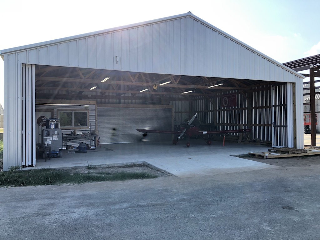

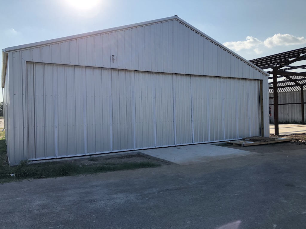

Just finished installing a 44'X12' HiFold door to my 50'X50' hangar. Installation was surprisingly easy using a fork lift to hold the door in place while you bolt the hinges to the header. Cables and locking mechanism already pre- adjusted, plugged it in an works like a charm. Very sturdy and well made steel frame. Door opens to 11'5"" only losing 7" of clearance. A very good value.
https://i.postimg.cc/YqHcC480/20200824-111450.jpg
Door $6800
Sheeting & Insulation $1000
Shipping $800
