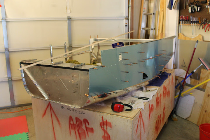

My garage is wide enough, but right around 20 feet deep. The completed fuselage, with empenage and tailcone attached, and the prop spinner and pitot installed, was just a couple of feet too long to fit in the allotted 20 feet. With the empanage installed, and your wings hanging on arach, things are a bit tight in a 12-foot room, but manageable.
I would install the empennage when before getting the firewall forward, get everything adjusted on the cables, etc. and then remove the empennage so that you have room (still tight to do the firewall forward. Then re-install the empennage at the airport. Removal/re-installing is few hours of aggravating work, diddling around with difficult to place washers, etc., but nothing that major.
As far as the gear goes, getting things wheeled through a 6-foot double door most likely won't work. I haven't measured just how wide the landing gear is without the the wheel/brake assemblies installed--if the width without the assemblies was less than the door width, you would have to figure some way of wheeling the fuselage out without wheels. If the gear legs were removed (another hour or two of grief), you might push it out using some moving dollies--just a bit tricky getting over the threshold bump.
I see no real boat-in-the basement problems here--some dis-assembly/creativity required, but nothing that a little creativity, and visits to Lowe/s aerospace can't solve.
Build what you can in the space. I have not yet installed the emp (even the first time) and I'll be starting the finish kit soon. What I can't or don't want to do at in the garage will all come together later or at the airport.

Right now the fuse is setting on the finish crate kit while its being built.
