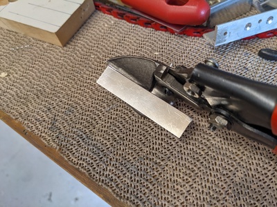

Okay, so with this post, I'm basically "outing" myself as someone who didn't know how to cut metal with snips for a long time. Sure I could make a cut, but I always ended up with a wavy edge requiring excessive sanding and/or filing. Another builder showed me this approach to get much better results and I'm passing it along in case it can help anyone here who is as dense as me.
After laying out your cut line, make an initial cut about 1/8" to 3/16" away from that line as I'm doing here. Make sure that the blade which is supporting the piece you want to keep is laying flat against the material.

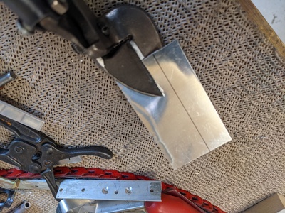

Next, trim away half to two thirds of the excess. As before, make sure the blade on the side of the "keep" part is flat against the surface of the material.

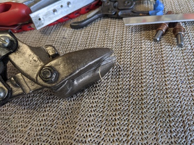

Lastly, cut on the line, of course keeping the blade on the "keep" side of the line flat against the material. Note the neat, undistorted edge.

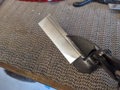

If you've done it right, the scrap material will curl into a spiral. This approach takes more time, but yields superior results as compared with making the first (and last) cut on your line.
