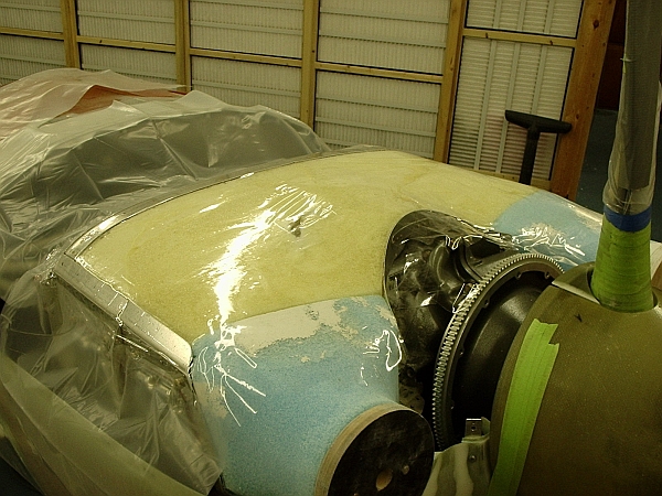

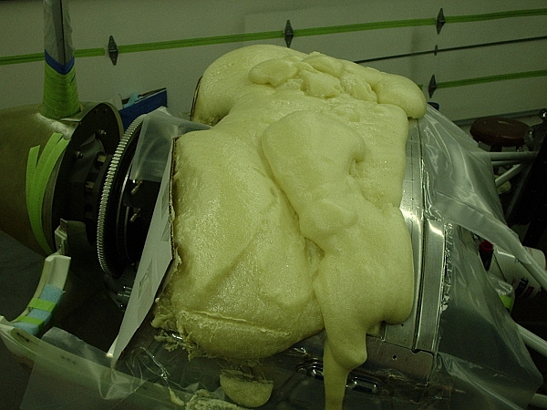

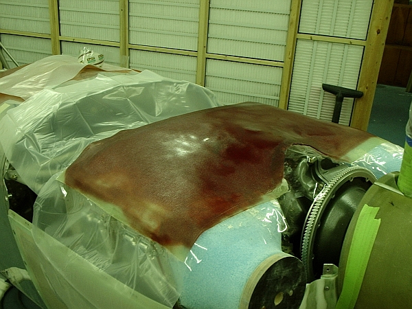

As to how to build a lid, I started with shaped foam. The yellow is pour-in-place over a plastic sheet to protect the engine.
The blue is shaped block urethane. Plastic sheet over the top prevents bonding to the foam:
Dark epoxy is high temp stuff.

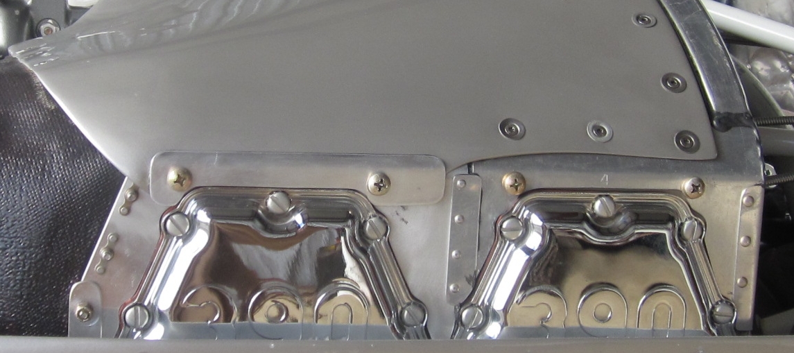

See the baffle flanges for attachment below? They cracked repeatedly above both front cylinders. Same at the ends of a nice curved flange I ran across above the propshaft. My lid has a long unsupported span across the top of the soft rubber inlets, so the loads were high at those points. Looked nice but wasn't holding up:
So, I ditched the aluminum flanges on the front cylinders, added flanges to the glass, and fastened directly to the cylinder ears with clamp plates for insurance. Also ditched the aluminum flange across the center, again adding a flange to the glass and placing the heavily loaded fasteners in shear. It has been working well since:

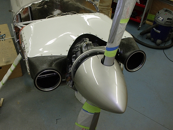

Michael, This is exactly what my hangar mate did with his cowl. The plenum top was laid up against the top of the cowl (easy to use mold shape), It was trimed and mated to the stock Van's baffles with fiberglass formed angles. Transitions to mate to the stock inlets were made and bonded to the plenum top.
The stock Van's cowl was used as a female mold to form two "snorkles". The snorkles are mated to the transitions with neoprene boots.
The nice thing here is that when the cowls come off, there is no need to break the inlet to plenum connections. The intake snorkles just hang there, waiting to be sandwiched back between the cowl halves when the cowl halves are put back on.
I have converted the transitions on my -6 to the same design. One flight with no problems but no data collected.
After much consideration, I think that this is the best inlet to plenum arrangement - perfect sealing with no drawbacks. I will try to get some pictures tonight.
