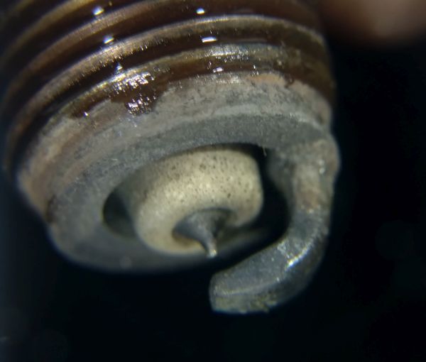

Here is a description of the behavior that prompted us to send a set off:
The P-mags report the current flow the EIC. A shorted or fouled plug would display as a maximum scale reading (100). A broken or open plug lead would display no bar graph (0). (We set the reported values to a 100 point scale for display purposes.)
When new NGK BR8ES plugs are installed, we typically see a value between 70 and 80. As they accumulate flight time, that value drops off and readings of 40 are not unheard of when 100+/- hours are recorded.
Obviously the plugs resistance is going up, limiting current flow. What I haven't done, is to Ohm used plugs and compared them to new ones because I believe the EIC reporting function.
The odd part is I could not detect any change in engine performance; either roughness or reduced performance. The only indication I had was what the EIC was reporting. Replace the plugs and the bar graphs to back up.

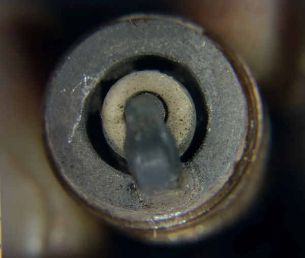

Typical example from a set of IHK27's after 213 hours in the 390. Sorry, cell phone photo is a little fuzzy; I'll do better next time. Some edge erosion of the ground electrode, which increases required voltage rise. Small gap increase too.
