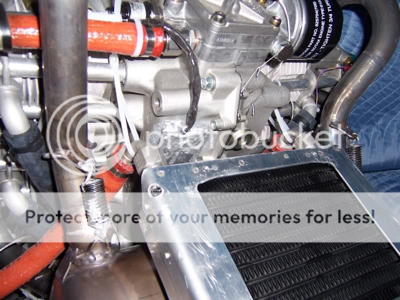

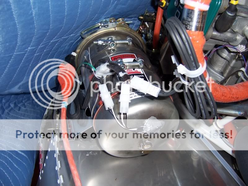

745# No AP, or Lights, but Moeller Marine Fuel Gauge, Oil Therm, Engine pre-heat, Heater Damper Door System, and minor other things.
John Bender
John,
can you tell me a little more about the engine preheater. I am far away from installing it but it would allow me to start much easier int he winter.
The flight school where I now rent uses the regular propane preheater, I would prefer one build in to the engine
thx
Peter
Reiff Pre-Heater
These show how it is installed. 150 watts ( low power ) Works great. With Packing Blanket over cowl, it keeps engine about 90 degrees F.
John Bender
