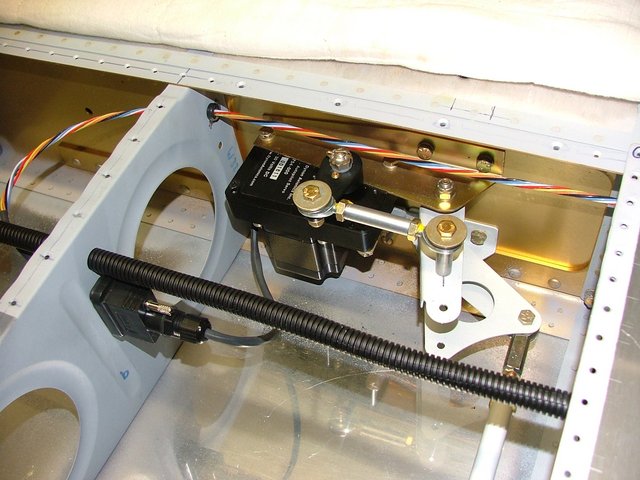

I used the standard Dynon wing mount kit for the roll axis, and made my own pitch servo mount. For connecting to the pitch bellcrank, I used Dynon's generic mount kit.
Here's the pitch servo. I don't seem to have a photo of the roll servo installation but it's fairly stock.
Here's a view of the pitch brackets.
With the roll servo, at first I installed GRT's servo and later replaced it with Dynon's. The Dynon one was easier to attach because the GRT one had a connector in a very awkward position. But the Dynon one did need a small bracket, supplied in their kit, for more rigidity, if I remember right. The wings are out at the hangar and I can't get there today for a photo.
Bottom line, I think that the 4/8 pitch kit and the 7/8/9 roll kits will work. Or you could assemble your own.

As Dave has said the pitch kit for the 4 & 8 works well and is straight forward to fit. I used the roll servo kit for the 7,8 & 9 and apart from a length adjustment to a support bracket it works well. However this is for the 3B wing and as the servo mount bracket replaces one of the bellcrank brackets this could be different for your RV 3A.

Next time I'm at the airport, I'll try to measure the radius from the pivot to the pushrod attachment point for you. Mine is the RV-3B installation very much like Russell's. Perhaps using the same dimension might work for you.
And maybe someone with closer access to their wings might beat me to it.
Dave

You might seriously think about mounting the roll servo in the wingtip. The bellcrank setup on the RV3 is different than the later models I believe from pictures I have seen and there is just no room in there for hands either to work with that rib in the way. I'm sure David will get you squared away with the pitch wig wag mount. Those rivets are kinda scary, should have bolts or at least screws there. Also if you make longer wig wag mount angles you can use them to mount your pitch servo also.
