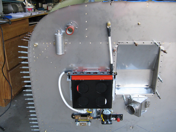

Find a place on the inside of the firewall above the battery and drill holes then bolt (using supplied bolts and washers) the grounding block to the firewall.
It becomes the common ground for all the electrical components and avionics.
It should be placed such that it can be accessed readily, but not accidentally.
The negative lead from the batter on the engine side of the firewall connects to one of the through bolts.

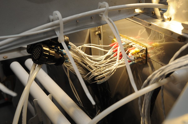

This is what it looks like in my installation.
Firewall side. Eventually when the engine went on, I used the other mounting bolt to hold the ground strap for the engine.
Interior side. Every circuit comes back to here, with just a few exceptions where some lighting circuits were locally grounded to the airframe.

Here's mine, all loaded up. The bolt goes through the firewall to tie to the battery ground point

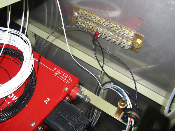

I put my FOT in nearly the same location on my RV-9A as Bruce.
But mine is a slider, so I'm not looking forward to the footwell yoga that will be needed to trace future ground issues when and if required.
I'd locate it lower on the firewall if I did it over again.
