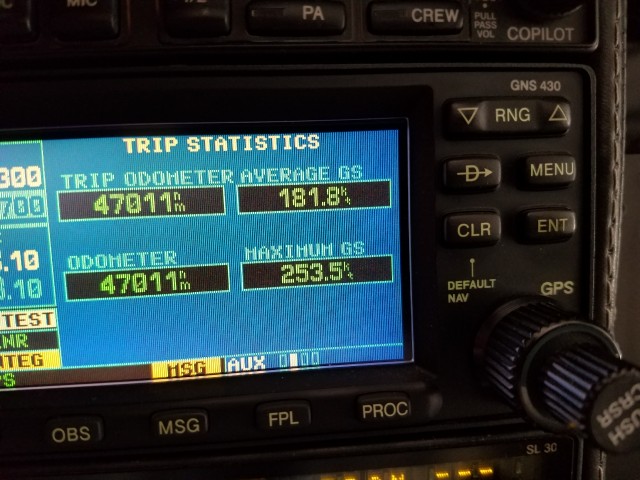

The fact is I do know what that my advance is at all times, I monitor the timing in both EI's. And if you think it's just "Spark, bang" and the gas is burnt you really need to study up on how ignitions and how fuel mixtures burn. If that were the case you'd notice no difference with one plug or two plugs firing in your planes engine. If that were the case racing engines wouldn't bother with dual plugs and extreme high energy ignitions. If burning the mixture at the exact right time didn't matter we wouldn't need accurate timing. The fact is the faster the fuel burns the more power it makes. Why do you think timing is set Before Top Dead Center? It's to start burning the mixture just before the piston hits top dead center, to get the most bang just as the piston heads back down. Low energy spark lights less mixture than a high energy spark, fact! Hence, the complete mixture takes longer to burn. Hence the piston is already heading down as the complete mixture is burnt. Next fact, a longer duration spark the more efficient the mixture is lit, the faster more complete the mixture is lit the more power is created from that charge. Low energy ignitions like mags and pmags do not burn the mixture as efficiently as high energy ignitions, fact.
And I don't care what you think, I know for a FACT that my Lancair 360 gained a good 15 knots when I removed one Bendix mag and replaced it with one ElectroAir ignition. BTW, the mags had a fresh overhaul. I tried a pair of pmags some years ago and lost a few knots (not to mention all the trouble they were), went back to ElectroAir and there were those missing knots back again. I really can't believe how little some people know about how ignitions work yet they have no problem installing them with little expectations. A good quality ignition, installed properly, WILL increase an engines horse power and overall performance.

15 knots on a 200+ knot Lancair or RV is a lot of power, like maybe 15%. I don't know anyone else who claims to gain 30hp on a 200hp Lyc using EI.

Following this discussion. A 15 knot gain would require a substantial increase in HP, no doubt.
That being said, I'm quite sure that while a 253 kt GS is impressive, that it absolutely no proof of the HP gain. With a strong tailwind, a C-172 could go that fast...

No it doesn't mean a HP gain. All it means is he finally got his timing set correctly for his engine and it is putting out it's rated HP. That coupled with an efficient airframe will easily gain you 15 knots. (He is not flying an RV.)
The same change in a 172 will gain you maybe 5 knots, maybe more, because it is a larger and dirtier airframe.
