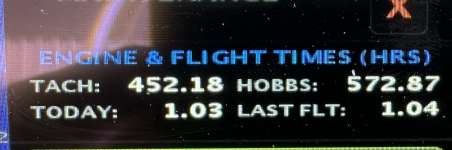

Is there any consensus in the RV12 community as to whether we should use the hours shown on the Hobbs meter vs. the hours shown on the tach for oil changes and Rotax 100 inspections? Checked mine today and we had 288 hours tach time and 389 hours Hobbs time. We've been doing our oil changes and 100 hours inspections based on Hobbs. Maybe we're spending too much money by not using the tach time?

The Rotax maintenance schedule uses Hobbs time ("All time during which the engine is running is counted towards the total number of operating hours. The time is counted irrespective of the load factor of the engine, such as idling or take-off power.")
There is a Skyview system setting for specifying the Cruise RPM (SETUP MENU > EMS SETUP > ENGINE INFORMATION). If the cruise RPM is incorrect the Tach time will also be incorrect. That might explain the large difference between Hobbs and Tach time.

His TACH number is 74% of his Hobbs. My Hobbs/TACH numbers are 403.7/333.6 i.e. the TACH is 82% of the Hobbs. Probably pretty common ratio with the Skyview/Rotax setup.

From the Skyview installation manual:
"Hobbs time is a simple timer that runs whenever the oil pressure is above 15 PSI or the engine is above 0 RPM. " "RPM is used when calculating tach time." "Tach time is defined as TIME x (CURRENT RPM / CRUISE RPM)."
The cruise RPM that's entered on the engine setup screen determines the ratio between Hobbs and Tach times.
Rules of thumb are sometimes useful but in this case, it's pretty much totally under our control through the Cruise RPM setting.
Rotax wants Hobbs. Hobbs usually records when the oil pressure is 15 psi or higher. The tach depending on how it is set up can be influenced by rpm. Low rpms the tach may turn slower and high rpms it may turn faster. The tach can be 15% - 18% different from a Hobbs. Rotax likes maintenance based on engine run hours no matter at what rpm.

Only partially true.
Extended taxi time, or sitting at the runway end waiting for lots of landing traffic will both change that Hobbs/Tach time ratio, regardless of what number is set into the Skyview.
