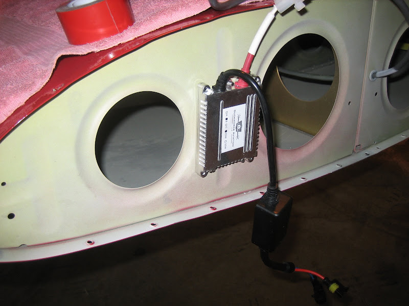

I have the CreativAir HID landing lights in my wing tips and have noticed a small amount of white noise on both radios (GNS 430W and SL-40) when the lights are on. The white noise remains even after the HIDs have warmed up. Any thoughts on how I can stop the white noise? Bill from CreativAir had no suggestions.
RFI to ant or pwr inputs
Usually, RFI gets into a radio either via the antenna or the power input. Wiring to other attached peripherals is a possibility, but far less likely. Could try unplug antenna and see if noise still there (I assume you hear it on receive). If so, the usual remedy would be to better isolate the source, or protect the affected device, reroute wiring, check shield grounds, etc.. If gone with antenna disconnected, then obviously it's the antenna location, connections, and/or the noise source must be lessened. I know there's different kinds of HID lights and some are supposedly far worse with RFI generation than others. One debate on shielded line, i.e. to strobes, etc., is do you ground at the likely source end of RFI or at the other end only, i.e. the power supply. Get into the same debate re field line to an alternator. Staying away from that discussion.

Yes, it appears that my lights from Duckworks are your system. The bulbs themselves are mounted about the only way they can be done in a Creativair tip (I used to have their Halogens - pretty low light output), you can see in the picture how I mounted the power supplies.
They are grounded locally, and I have an Archer Comm antenna mounted in the tip, and grounded to the outboard rib as well. I have the identical setup in the other tip, except that the antenna is for Nav, and I have noticed no degradation in Nav reception with the lights on or of.

Try powering the HID(s) from a separate source (car battery). While HID(s) are on, see if you still have the same problem(s), if so filters in the power wires (either at the ballasts or the affected radios will not help). It is an RF (radiated) not a conducted noise problem in that case. When doing this test also isolate the ballast case from ground (the airframe).
When making this test, If operating the ballasts independent of the aircraft electrical system the problem either all or mostly goes away. The ballast is putting the noise onto the electrical buss, + - or both. Some times isolating the ballast case (metal housing) from ground can also help this. This way the ground wire is the ONLY grounding path (no ground loop is created).
One filter which should help or eliminate a buss conducted noise problem is available from ACS made by Lonestar, it is called the "Eliminator" ACS P/N 11-08055 or from many other sources LS P/N 122253-10A $110-$120 each depending on source. It can be located at the offender(s) or at the affected radio etc. It is limited to a 10 amp current flow.
In the end if its RF radiated, Cable shielding may be needed from ballast to igniter and igniter to bulb and greater distance from HID to antennas may be required. Just isolating the ballast case from ground may do the trick, so that the ballast neg power wire is the only grounding path.

I have 50W MR16 HID systems in each wingtip. The ballast and starter look just like the pictures posted earlier.
In the beginning, they broke the squelch on both my 430 and SL40. I used a handheld radio to see how much RF was radiating (and try to determine the source). This was partially successful. The RF appeared to be coming from the igniter (the box in the leads from ballast to bulb).
I fabricated a grounded shield around the igniter with a wire and some aluminum foil. For me, it has reduced the RF just enough such that it stays under my squelch level after the arc is established.
I think it could be better. The next time I have the tips off, I will probably put on some more shielding, or maybe try the idea above about insulating the ballast from the airframe (my grounds go back to the firewall).
GOT IT!
Yaa Hoo!.
I fixed it for good. Found by accident.
As stated above, the aluminum foil faraday cage helped. I grounded it to the airframe with a wire. Still had noise but it was less. I had the right tip off, trying to figure out what to do next. I was using a handheld tuned to ATIS and wanding it around all the HID parts. I moved the harness and suddenly the noise dropped big time. A little inspection showed that the aluminum foil was touching the end rib. Ah ha!. My grounding wire is not doing the job! I firmly zip tied the foil covered box to the end rib so there was firm contact between the foil and the rib. Noise was gone as far as I could tell with the handheld.
Flew today and confirmed it. No squelch break and little to no hiss during receive/transmit. Tower said I was 5x5 and I could hear them very clearly.
