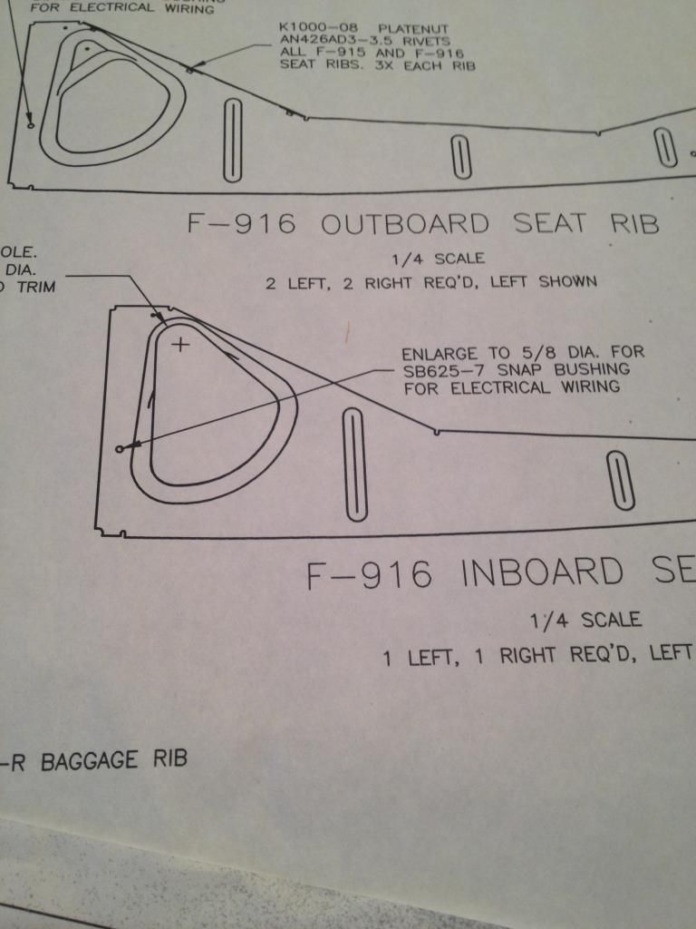

Hey all,
Well, I have my 9A center section all assembled and I realized I forgot to enlarge the tooling holes in the ribs to 5/8" (bottom rib in illustration below). Too tight to get a regular drill in there now. I have a 90deg angle drill but it takes threaded bits. Does anyone know where/if I can get a 5/8" threaded bit? Also a 5/8 chassis knockout punch would work but I can't find one that small. Any other thoughts?
