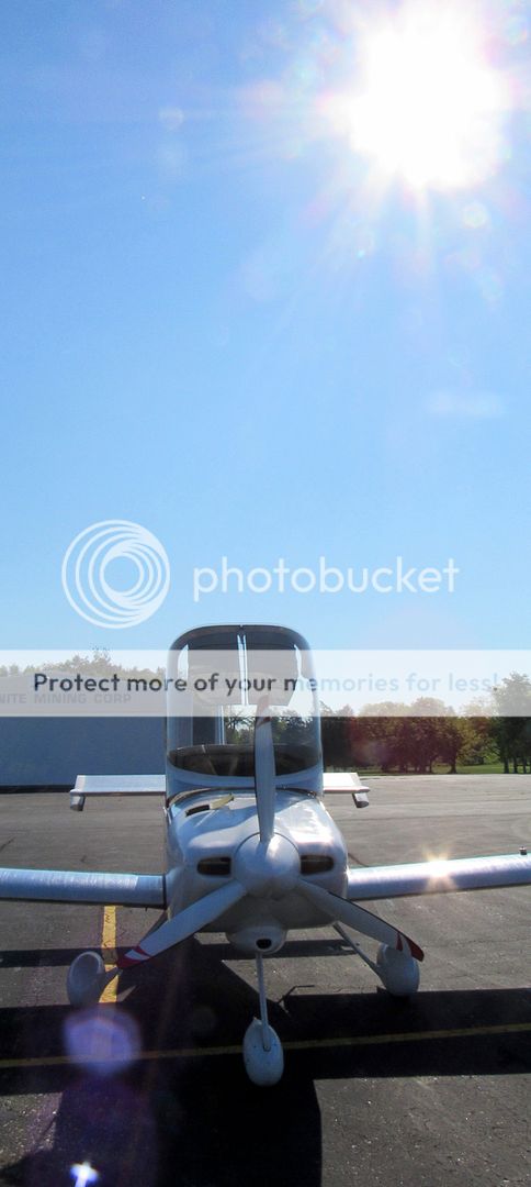

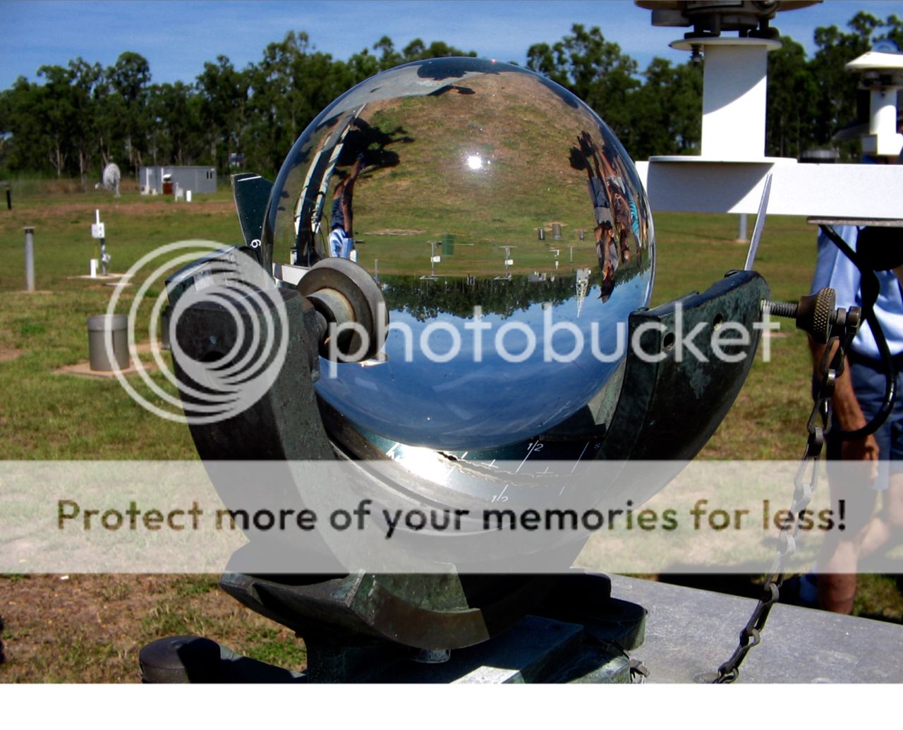

For couple years I was puzzled how my brand new glare shield got a burnt spot. I didn't solder anything in the cockpit and my passengers usually don't smoke. Then I got another a bigger one. Then one day I returned to my aircraft to see a touch of smoke coming out of the cockpit. Now I know why. Ever heard of a heliograph or sunshine recorder? Your RV bubble canopy can be one of these.
Watch the sun at your six thirty.

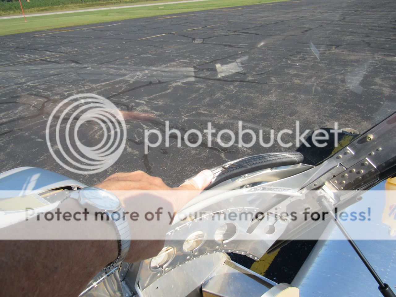

Your bubble canopy (tip up in my case) becomes a powerful magnifying glass. Your finger won't stay like this for too long you feel the heat right away.

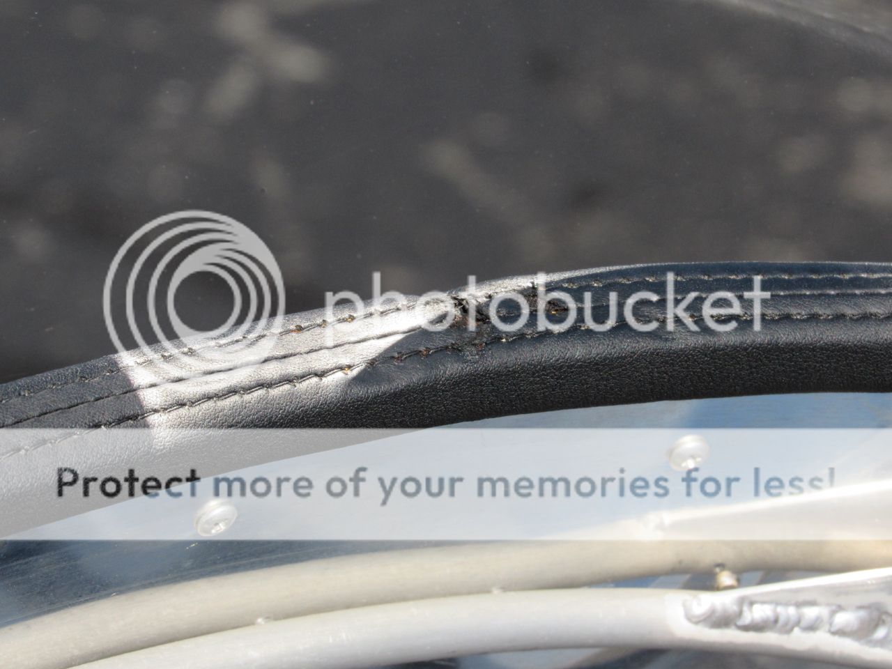

These marks I acquired through 4 years of flying without even knowing the cause. Only last year I was able to figure it out after seeing a smoke. Did anybody experienced something similar? What would happen if your glareshield is other then aircraft designed part?

Certainly. If possible avoid sun position between 5 and 7 o'clock with tip up canopy open or propped.

Based on personal experience with a Sport Criuser, the interior surface of the open canopy reflects and focuses the sun's rays in a concentrated spot that melts/burns the top of the glareshield. Only occurs with tip-up canopy OPEN and tail toward the sun. Sun has to be at relatively high angle, IIRC, at least in the Sport Cruiser geometry. Happens in the blink of an eye. Pick your combustables carefully...
With regard to the question of reflection vs. Refraction... the relatively low angles of incidence leads me to believe that the phenominon is based on reflection rather than refraction. Refraction at shallow angles dissipates so much energy within the plexi. I have not done any ray tracing to verify this.

I found two parallel deep burnt gouges in the upholstery of one of the seats in my RV6. One was about 4" long and the other a little shorter. Had to reupholster the seat.
