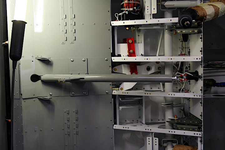

I can confirm that the big 22000 µFd capacitor is the noise filter for the fuel pump as I have it sitting on the bench yet. My autopilot filter is buried in the plane so I can't confirm the value Joe gives but he is a trustworthy guy ;), the Van's part for the autopilot servo filter is "ES-00103 Noise Filter" in the inventory sheet, if you want to order it from them. It comes with nice leads and spade connectors. They only use one on the pitch servo which is under the pilot seat and near the PTT and headset wiring. The noise filter is visible in the picture.
[url=http://tonytessitore.smugmug.com/RV-12-Project-N577RV/Autopilot/10366521_wJzx6#722250187_PNpkt-A-LB][/URL]
The roll servo is behind the rear bulkhead and they don't put a noise filter on it.
Tony
Oeps, I read only the quote in posting #26 about the fuel pump filter but the question was about the servo filter.
Fuel pump capacitor = 22000 µF
A/P & light noise filter= 2200 µF

Tony, an old post but I'm interested if the noise filter at the electric pump stopped the ticking? If so, then is it a simple install? If there is such a thing??
Doug in IL
The noise filter at the fuel pump does stop the ticking in the headset. It does not stop the sound of the pump running.
The install is not real easy as the space is limited, the flaperon pushrods are in the way, and you will be working with an adel clamp in there which is always a challenge in tight spaces.
If the flaperon pushrods are not installed yet, it would be an easy job to install the fuel pump noise filter.
Thanks Tony,
Does the part come with install instructions? Is it Possible to install without disassembly? Oh and is it a simple electrical connection?
Doug in IL
Doug, I don't remember whether instructions came with the noise filter, that was 6 years ago, but the installation is now on page 31B-22:
I think I installed it without disassembly. The electrical connection is simple, just unplug the fuel pump spade connection and plug in the noise filter in series and install the ground terminal.
If you have a solid layer of primer laid up prior to assembly this could also cause grounding issues, you may want to validate your grounds
