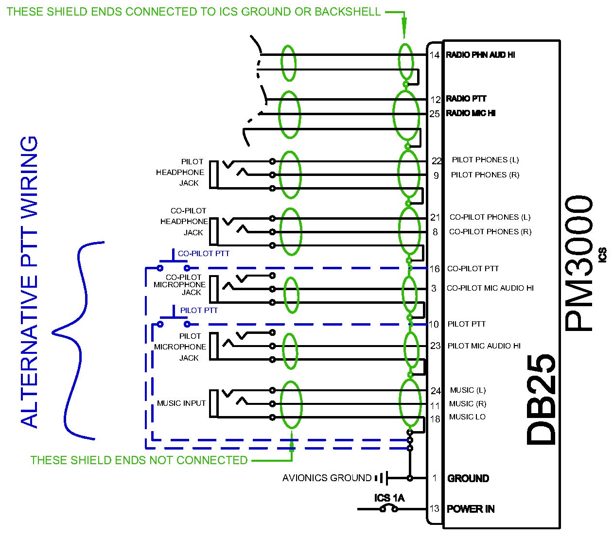

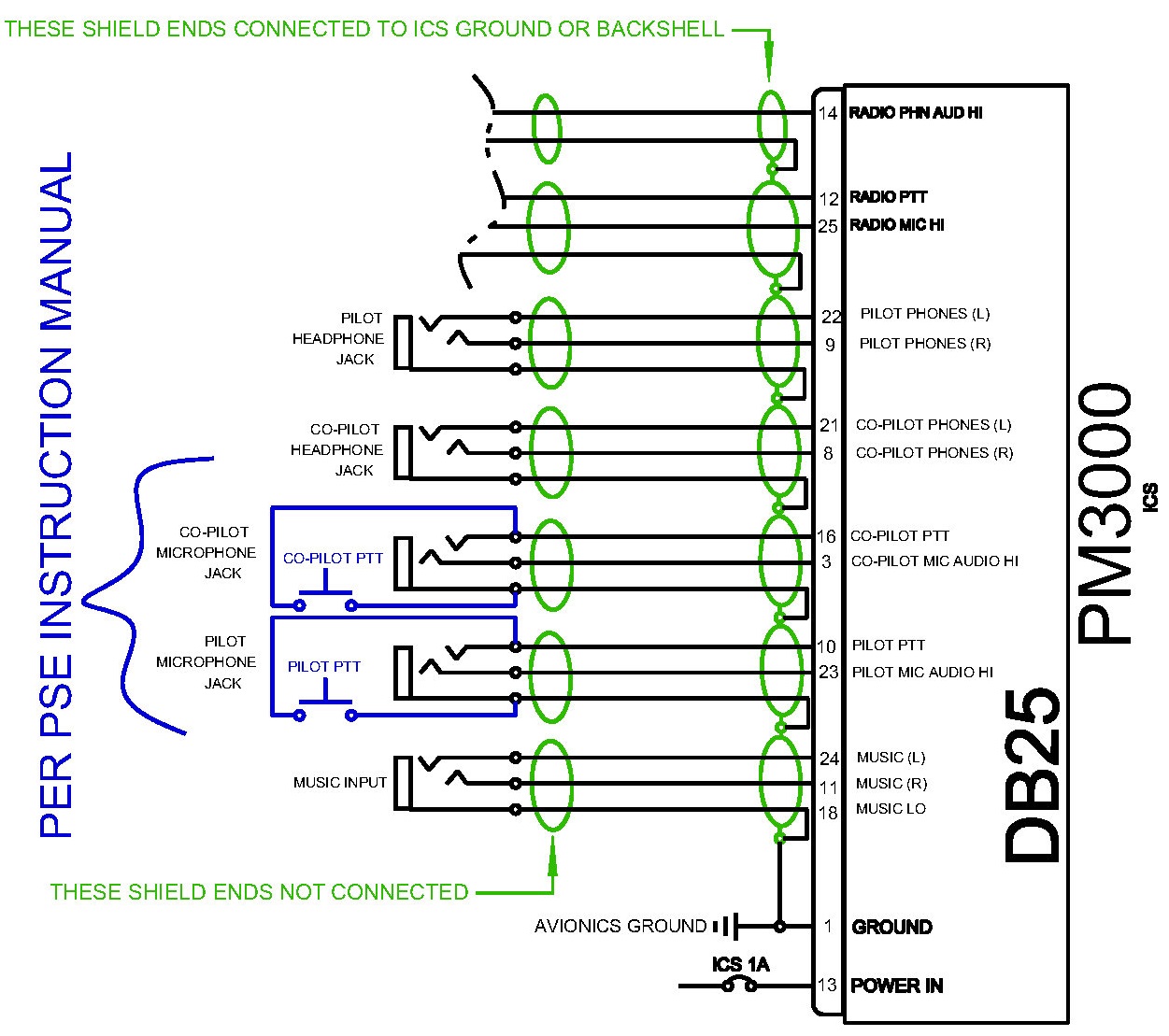

Here are a couple of diagrams I whipped up for you (stereo headphone jacks). I show the answer to your shielding questions in green and the PTT circuits in blue. The first shows the PTTs connected to the microphone jacks and the second (alternative) shows the PTTs wired direct to the ICS/audio panel.
DIAGRAM 1:
DIAGRAM 2 (ALternative):
The second alternative can be useful for PTTs installed on the sticks where it is more convenient to run their wires directly to the ICS/audio panel instead of looping back to the headset jacks. If the PTTs are installed on a panel near the headset jacks then the first diagram showing the jack connections might be more convenient.
