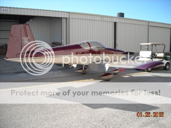

While I was building, I flew a Cessna 172.
I bought this winch from Wag Aero because it was impossible for one person to push the plane up a 3 degree slope into my hangar.
http://www.wagaero.com/standard-aircraft-winch.html
The first time I pulled the 172 into the hanger I used the rear tie down ring.
I heard this terrible creaking noise from the area of the tie down ring.
The second time I pulled the 172 in I tied tow straps to the landing gear.
A real pain.
Before a third time, I sold the winch and bought a golf cart.
The winch worked fine, I was just not comfortable using it on my plane.
