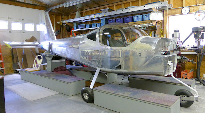

I am 72 and I agree with you this is not the best aircraft design for the older people that makes light sport a good option.
A handle is something that I am trying to design that will stick out of the aircraft when on the ground and retract in when in flight.
The step is also something that I think could need improvement and may be even at the back of the wing.
I have had this problem in mind since I first got into the 12 at Oshkosh at the age of 68

The issue is that their leg strength and balance is not sufficient to do the above method. They have to put both feet on the wing, get their back straightened up, catch a couple breaths, then proceed into the cockpit. Getting out is even more of an issue for my non-pilot friend. We'll do some tests and practice before flying to be sure he can do it on his own.
Handle location
Scott
The statement you made is correct ( The higher you are above any of the places that you have available for hand holds )
This is the issue, moving the wing back in the design of the twelve helps the forward view at a trade off of rear entry of the wing like all aircraft, I am not saying this was a bad thing.
I am not trying to criticize the front entry, I am just trying to find a way for us older people with less led strength and balance issues to enjoy their twelve in their golden years.
I will add a handle at the back of the roll bar and a different step to try to make it a little easier to enter the twelve.
Standing on the wing with only one foot and opening the canopy is a little above my ability.
I am still considering moving the step to the back of the wing and extending the walk area to the flaperon.

Now, for my ingress/egress story. I'm 78, and my wife is a few years my junior. We struggled for a reasonable solution for getting in and out of our new bird. Then, we came across an article that I think was written by Dick VanGrunsven himself. In fact, I even think there was a short video sowing how it is done. The pilot, and passenger procedures are mirror image actions. You walk up to your side of the airplane facing the fuselage at the forward wing root. With a hand on the canopy rail, and using your forward foot, step up on the step. Now merely step into the floor of the cockpit with your other foot, and stand up. No need to use the wing at all. Getting out is just a reverse procedure. The only tricky part is knowing exactly where the step is located, as you won't see it as you exit. You soon learn that it directly in line with the face of the instrument panel. It will take a few attempts, but it serves us very well now. Hope this helps.....Tom

Only if you are tall. I am 5 ft 7 and tried that, I lack about 10 inches from being able to reach the latch.
Don, another 12 pilot in my EAA chapter pointed out that you can reach the canopy latch when you stand at the back of the wing. I felt a little silly after trying it... considering the dozens of times I crawled hoisted myself up on the wing to do it.
I have a fairly short inseam, but tried this and there is no way I could ever do that even when I was young and agile. I think it would take some long legs (at least a lot longer than mine) to make that giant step into the cockpit.
Back to the old drawing board I guess.

Experimenting some today, the really big problem is getting the darned canopy unlatched! Once it is open, many avenues open up to enter. Am dreaming of some sort of remote latch down on the side where it can be reached by short people. Would like to stay away from electric remote stuff if possible. Maybe even ignoring the main latch and adding a simple one down low on pilot side. Come on guys and gals, help me think of something!
Would this lightweight plastic stool work?
http://www.rubbermaid.com/en-US/shop-products/cleaning---utility/step-stools/step-stool
Stand on the stool to reach the latch. Lift the canopy, put the stool in the baggage compartment, and enter the plane the usual way.
At the end of the flight, set the stool on the wing or toss it onto the ground, then exit the plane the usual way. You can then stand on the stool to latch the canopy. If you need to leave the plane on the ramp, tie the stool to a tie-down chain so it doesn?t blow away.
