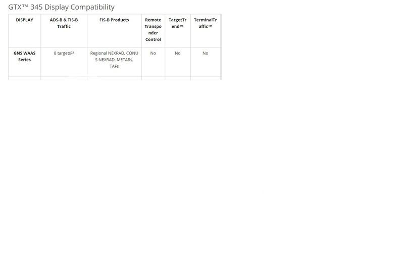

I am working on an avionics upgrade at the moment and have a question. I will be installing a 430W and probably a GTX335 for the ADSB-out solution. Garmin's product literature mentions specifically that the GTX335 and 345 interface in some particular way with the 430W but nowhere online can I find specifics of what this means. I know that the 600 and 700 series are capable of controlling the 335/345 transponders (at least the remote versions). Is this also what is implied in saying that the transponders interface with the 430W/530W?
If so, has anyone done this, and what does it look like on screen?
I know that the 430W can display traffic and weather if supplied by a 345 (that much is clearly stated) but Garmin's literature has me at a loss for what it means for a 335 / 430W combination. If I could use my new 430W to control a remote GTX335 that would be great and save me some panel space that I would like to retain.
Any ideas about what I am missing?
Edited to not that I hate auto correct because it messed up my title for this thread. "GPS 430W" is supposed to read "GNS430W"
You will get ADSB out capability with the 335/430W. You will get traffic and weather on the 430W from a 345. All via ARINC and RS 232. No transponder control from a 430.......I think!
I don't see any way for the GNS4xx/5xx to run a remote transponder, so you'll need a panel mount one.
The GTX335/345 use one RS232 and one ARINC 429.
The RS232 is to supply the transponder with position source data for the ADS-B out message.
335 - The ARINC 429 provides TIS-A to GNS4xx/5xx.
345 - The ARINC 429 provides :

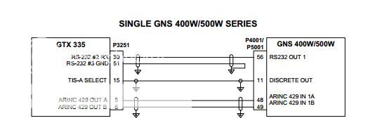

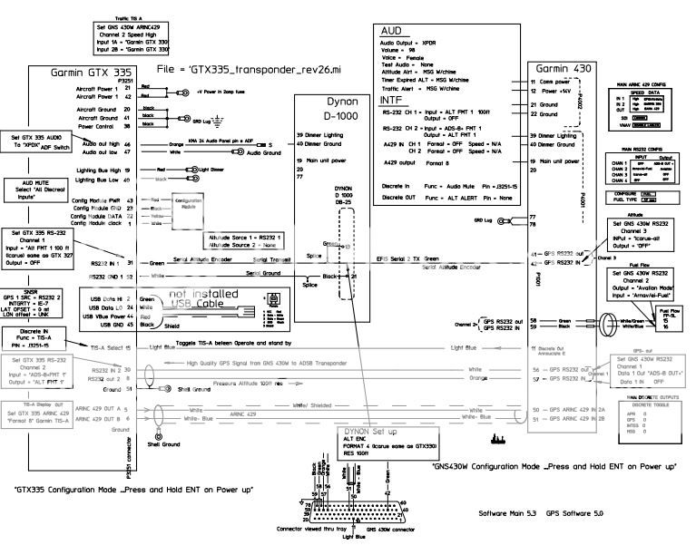

GTX335 connected to a GNS430W Install Question
I recently purchased a GTX335 (transponder) and Currently in the process connecting it to my existing GNS430W (Nav Source) which I had the Software updated to Rev 5.3 (current I believe)
here is the suggested connections in the back of the Garmin install Manual
and this is how I am hooking things up and configuring the devices
a close up

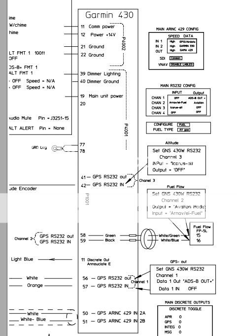

My Question is how does one set the configuration on the GNS430W so that
it toggles pin 11 (Discrete Out Annunciation E) for the TIS-A ...Can't seem
to find it in the Discrete out selection for the 430W
Thanks in advance for your help

Hello Mcminn,
No configuration is required for the TIS-A Select discrete output on pin 11.
The GNS configures this automatically when a TIS-A traffic receiver like the GTX 335 is connected/configured.
Steve
Steve,
Thanks so much for you help!
I got everything wired and gtx 335, gns340W configured .
just about to do my verification flight, request a report and see if I got everything right. waiting on the weather to improve,
Thanks again
