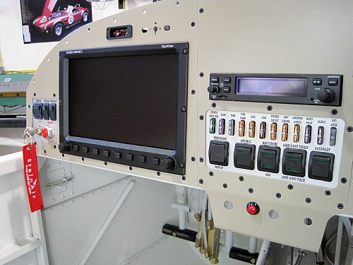

Just finished up my install of the new radio and wiring.
I chose not to replace the left panel. I already had it drilled and painted. I plan to cover the holes for the intercom with a N-number plate anyway.

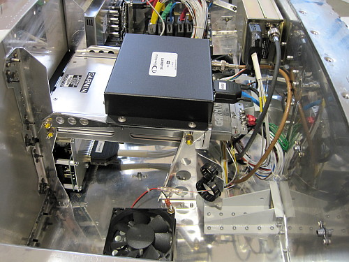

Randy,
What are part numbers for the ADSB brackets? I upgraded to the new Garmin GTR but the SL 40 ADSB brackets don't fit the new radio and I didn't get any updated instructions or brackets for the ADSB. I guess $1400 doesn't buy what it used to!
Bruce
Sorry Bruce, I've been slow to catch up on the threads.
The part numbers are F-00045B-L and F-00045B-R. Those are the two brackets that bolt to the GTR200 mounts and provide a mount for the ADS-B radio.
